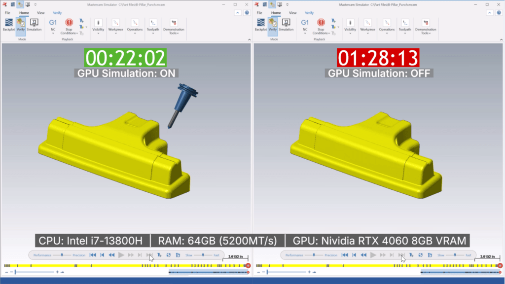

  • Realtime performance gains when Tool vs. Stock collision detection is enabled
With a compatible GPU, simulations that previously took hours may now finish in minutes — even at full resolution.
Real World Impact

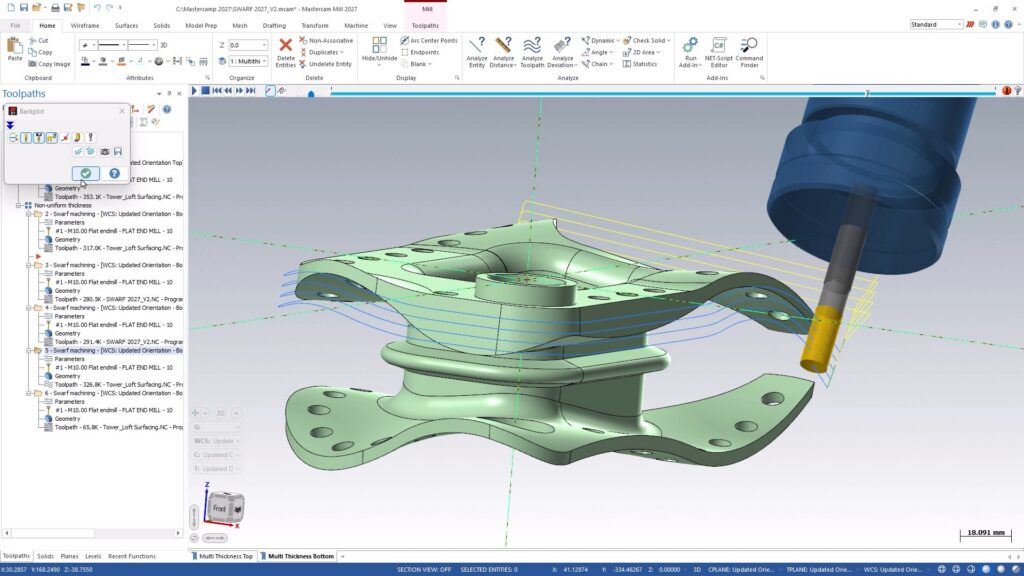

Take a typical multiaxis aerospace component:
  • Traditional CPU simulation: 3–4 hours at practical resolution
  • GPU accelerated simulation: Often 15–20 minutes at maximum resolution (depending on hardware and setup)
Time saved per part: 2.5+ hours
