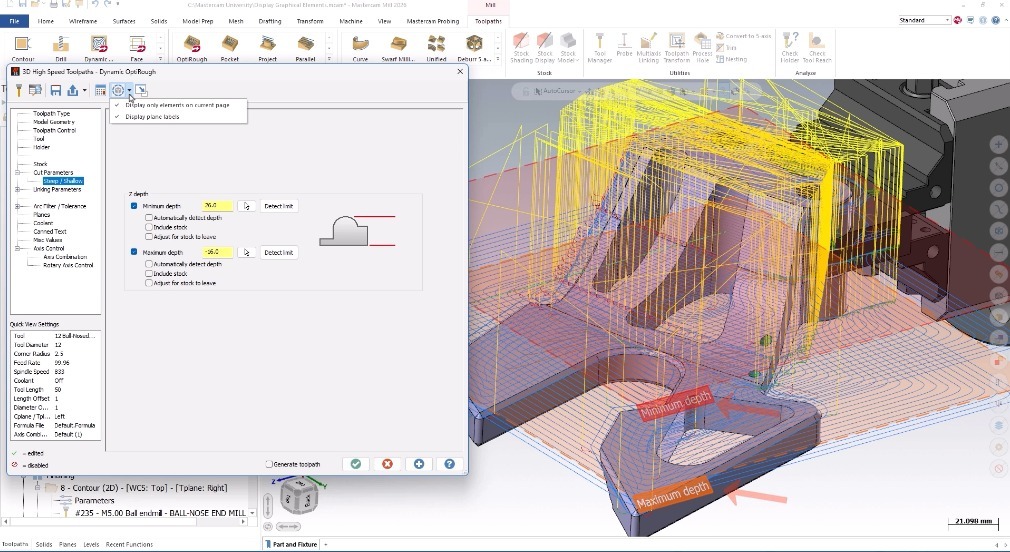

The Display Graphical Elements controls are located at the top of the Toolpath Parameters window for supported operations. Every compatible toolpath includes a dropdown menu that allows users to enable or disable graphical elements and access additional display options.
The specific options available vary based on whether the operation is a 2D, 3D, holemaking, or multiaxis toolpath, but the goal remains the same: providing a clearer understanding of how a toolpath is configured.
Key Display Options Explained
One of the most useful settings is Display Only Elements on Current Page, which is enabled by default. When active, Mastercam only displays graphical elements associated with the parameter page currently being edited. This helps reduce visual clutter and keeps the focus on the settings you’re actively working with. Disabling the option causes all graphical elements associated with the toolpath to display at once, which can be useful for seeing the complete picture but may become overwhelming on more complex operations.
Another common option is Display Plane Labels. When enabled, plane names are shown directly in the graphics window, making it easier to identify and verify plane assignments. When disabled, planes are represented by simple colored markers instead.

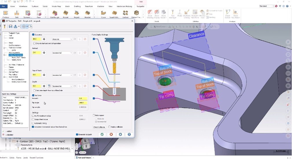

Holemaking operations offer a more streamlined implementation. The focus is primarily on depth and positioning verification, with plane-related information serving as the primary graphical reference. In these operations, tip compensation is displayed instead of breakthrough on the linking parameters page.
Users may also notice color changes on selected hole geometry; however, this behavior is separate from the graphical elements feature and remains visible whenever active hole geometry is selected.

For 3D toolpaths, graphical elements can display machining geometry, avoidance geometry, workholding geometry, control boundaries, curves, points, and steep/shallow planes. Depending on the operation, users may also see approximate start points for multiple machining regions and graphical representations of clearance values.
These visual indicators provide another layer of validation, helping programmers confirm how the toolpath interacts with the model before machining begins.

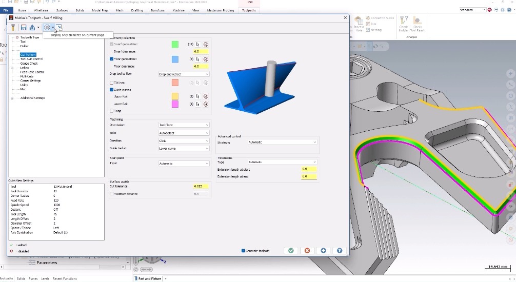

Multiaxis toolpaths provide perhaps the most varied implementation. The graphical elements displayed depend heavily on the selected toolpath strategy but generally include machining geometry, avoidance geometry, and cut pattern information.
It is important to note that not every multiaxis toolpath supports graphical elements. Legacy toolpaths such as 5-Axis Curve, Multi-Surface, and Flowline do not include this functionality, so the Display Graphical Elements option will not appear in their parameter windows.
