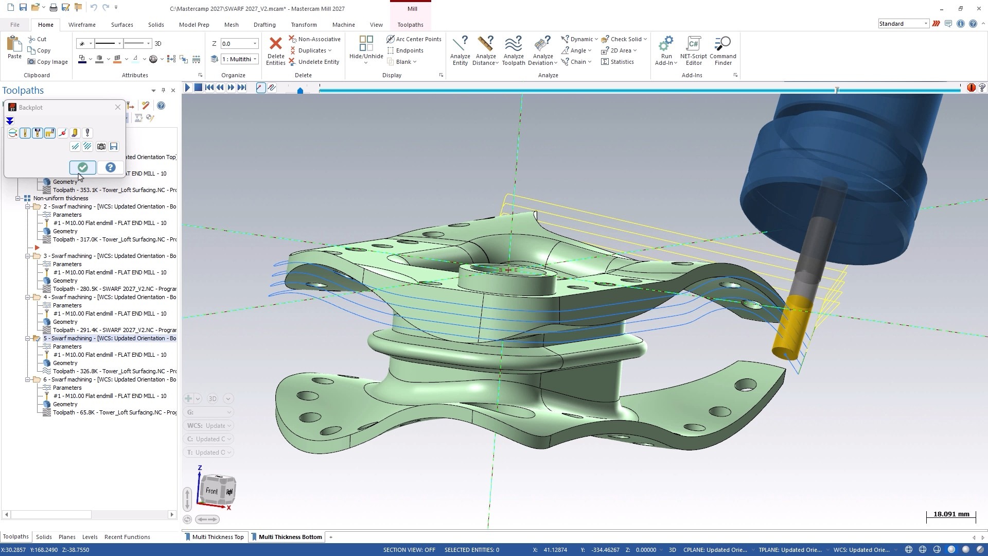

More Control for SWARF Milling
SWARF machining remains one of the most efficient finishing methods for complex surfaces because it leverages the side of the tool during simultaneous 5-axis motion. Mastercam 2027 introduces new multi-cut alignment options that provide greater control over how SWARF toolpaths are generated.
Available in the Swarf Milling operation’s Multi Cuts page, two new alignment methods help users create more predictable and desirable multi-pass finishing strategies:
Align with Cutting Part
For single-cut operations, this option guides the tool along the upper curve of the SWARF geometry, giving programmers more direct control over toolpath direction.
Align with the Longest Contact Line
This option generates multiple cuts that remain parallel to the upper curve, helping maintain consistent engagement across the swarf surface.
Benefits
- Greater control over toolpath direction and motion
- Improved surface finish quality
- More predictable multi-pass finishing patterns
- Improved results on complex SWARF geometries
- Consistent tool engagement in challenging machining scenarios
For users who depend on SWARF toolpaths as a primary finishing strategy, these enhancements deliver increased precision and flexibility while helping achieve higher-quality surface finishes.

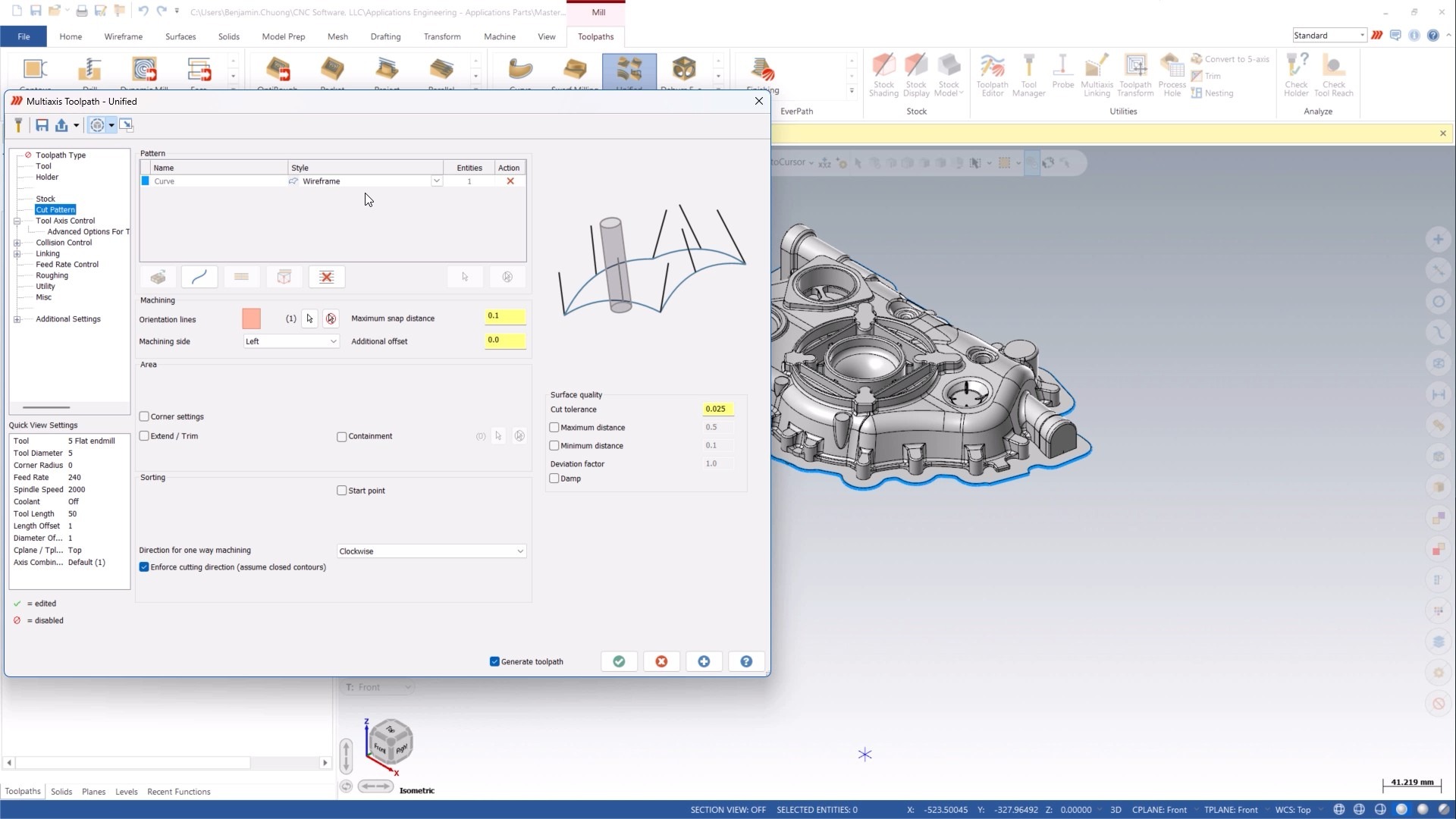

Expanded Tool Axis Control for Wireframe Toolpaths
Wireframe-based multiaxis programming now benefits from the same familiar tool axis control options available throughout other Unified strategies.
Located in:
- Multiaxis → Unified → Curve → Wireframe
Users are no longer limited to orientation lines when controlling tool direction. The additional axis control methods provide a more consistent programming experience across the unified toolpath family.
Benefits
- Access to familiar Unified Tool Axis Control options
- Improved consistency across strategies
- Reduced need for auxiliary geometry
- Faster toolpath creation
- Simpler control of tool orientation along wireframe curves
For users who regularly machine from wireframe geometry, this enhancement streamlines programming while providing greater flexibility.

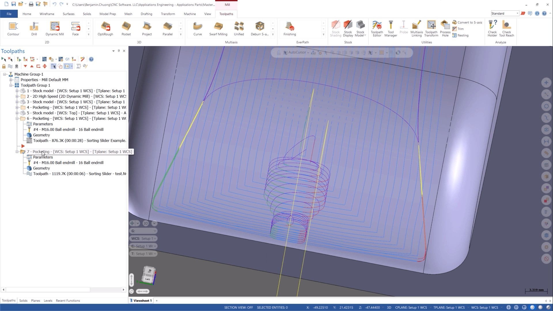

Multiaxis Pocketing Gets Smarter
Mastercam 2027 also introduces several significant upgrades to Multiaxis Pocketing, helping users improve safety, finish quality, and machining efficiency.
Fixture Geometry Awareness
Complex setups often involve fixtures positioned close to machining areas. Mastercam 2027 now allows users to define fixture geometry directly within Multiaxis Pocketing operations.
The toolpath automatically considers these fixtures and maintains user-defined clearance values throughout the operation.
Benefits
- Automatic fixture collision checking
- User-defined clearance protection
- Smarter roughing toolpaths
- Reduced crash risk
- Less manual verification and adjustment
By making the toolpath aware of the complete machining environment, programmers can create safer and more reliable operations with greater confidence.
New Rest Finishing Strategy
A new Rest Finishing pattern has been added to Multiaxis Pocketing, making it easier to identify and machine material left behind after initial finishing operations.
When larger-radius tools are used to efficiently finish walls and floors, leftover stock often remains in corners, fillets, and tight transitions. The new Rest Finishing options automatically target those areas with smaller tools.
Rest Finishing Methods
- Fillet Boundary
Automatically creates rest regions using pocket fillet geometry.
- User Defined
Allows programmers to manually define rest regions using selected geometry.
- Previous Operation
Uses previous wall and floor finishing operations to identify remaining material from stock models that larger tools could not reach.
Benefits
- Faster finishing with larger primary tools
- Efficient cleanup of remaining material
- Improved corner and fillet finishing
- Reduced programming time
- More streamlined finishing workflows
This flexible approach helps shops balance productivity and precision while minimizing manual programming effort.
Extend Toolpaths for Better Finishes
Mastercam 2027 introduces a new enhancement that automatically overlaps closed finishing toolpaths within Multiaxis Pocketing.
The overlap distance is calculated directly from the selected tool geometry, eliminating the need for manual calculations or adjustments.
Benefits
- Automatically calculated overlap values
- Reduced cusps and witness lines
- Faster setup and programming
- Seamless integration into finishing workflows
- Extend tool life, reducing chatter, even tool loading on entry and exits between passes
When enabled, adjacent finishing passes overlap slightly, creating smoother transitions between cuts and producing cleaner, more consistent finished surfaces.
