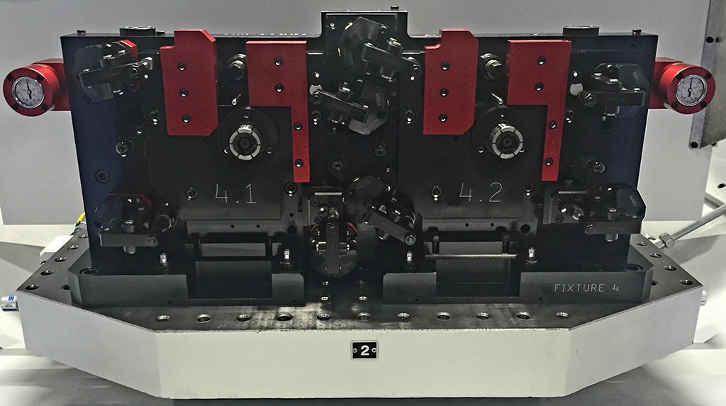

![Black and red metal hydraulic workholding fixtures](https://www.mastercam.com/wp-content/uploads/2023/04/Hydraulic-Workholding-Fixtures-1.jpeg)

![Black and silver metal toner hydraulic workholding fixture](https://www.mastercam.com/wp-content/uploads/2023/04/Toner-Hydraulic-Workholding-Fixture-1.jpeg)
In one instance, Toner used Dynamic Motion to reduce machining time for a complex airfoil. The workpieces consisted of 100-pound blocks of aluminum measuring 3 x 20 x 36 inches. In half the time it took to manufacture the same type of part using a conventional process, this part was whittled down to 15 pounds, leaving a 35-gallon barrel of chips beside the machine. After the first part was completed, five more followed, making these standardized dynamic toolpaths an important productivity enhancer.
