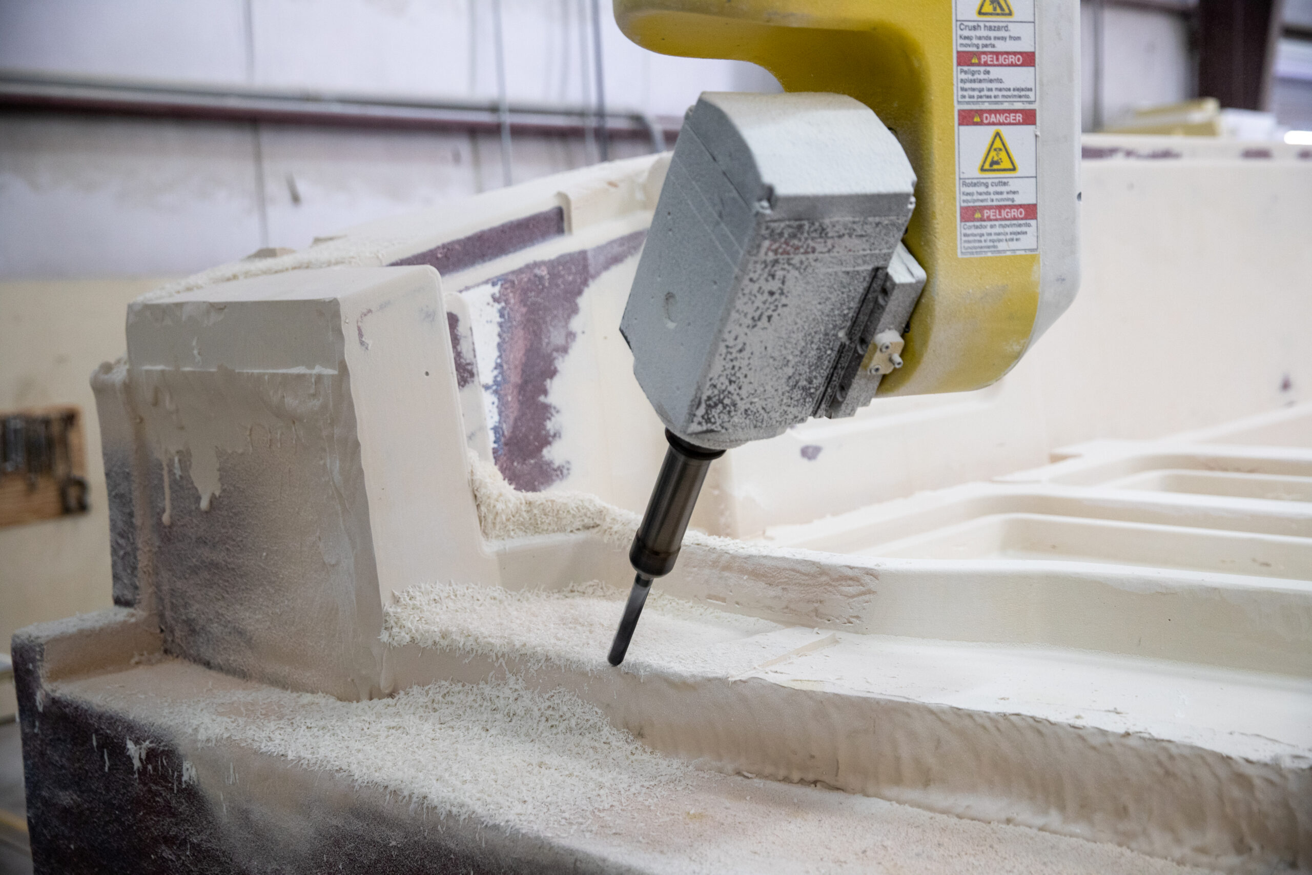

By keeping programming and machining aligned, the team can move directly from design to production without delays. Large-scale CNC equipment relies on advanced toolpath strategies such as multiaxis flow, raster, and scallop finishing to deliver high-quality results across complex surfaces.
Critically, Mastercam enables real-time responsiveness on the shop floor. When design changes are required, teams can quickly modify components, re-machine parts, and continue production without restarting the process. This capability is central to maintaining both speed and accuracy.

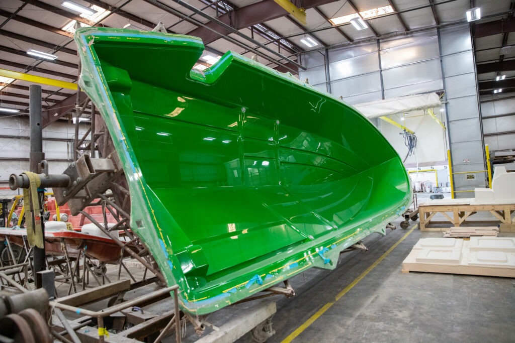

Production begins with CAD modeling and progresses to machining full-scale patterns and molds. These molds are then used to produce fiberglass components, which move through finishing, assembly, and final preparation.
The facility is equipped to handle highly complex geometries, including large catamaran structures and fully integrated interior liners, where many features are molded directly into the part rather than added later.
