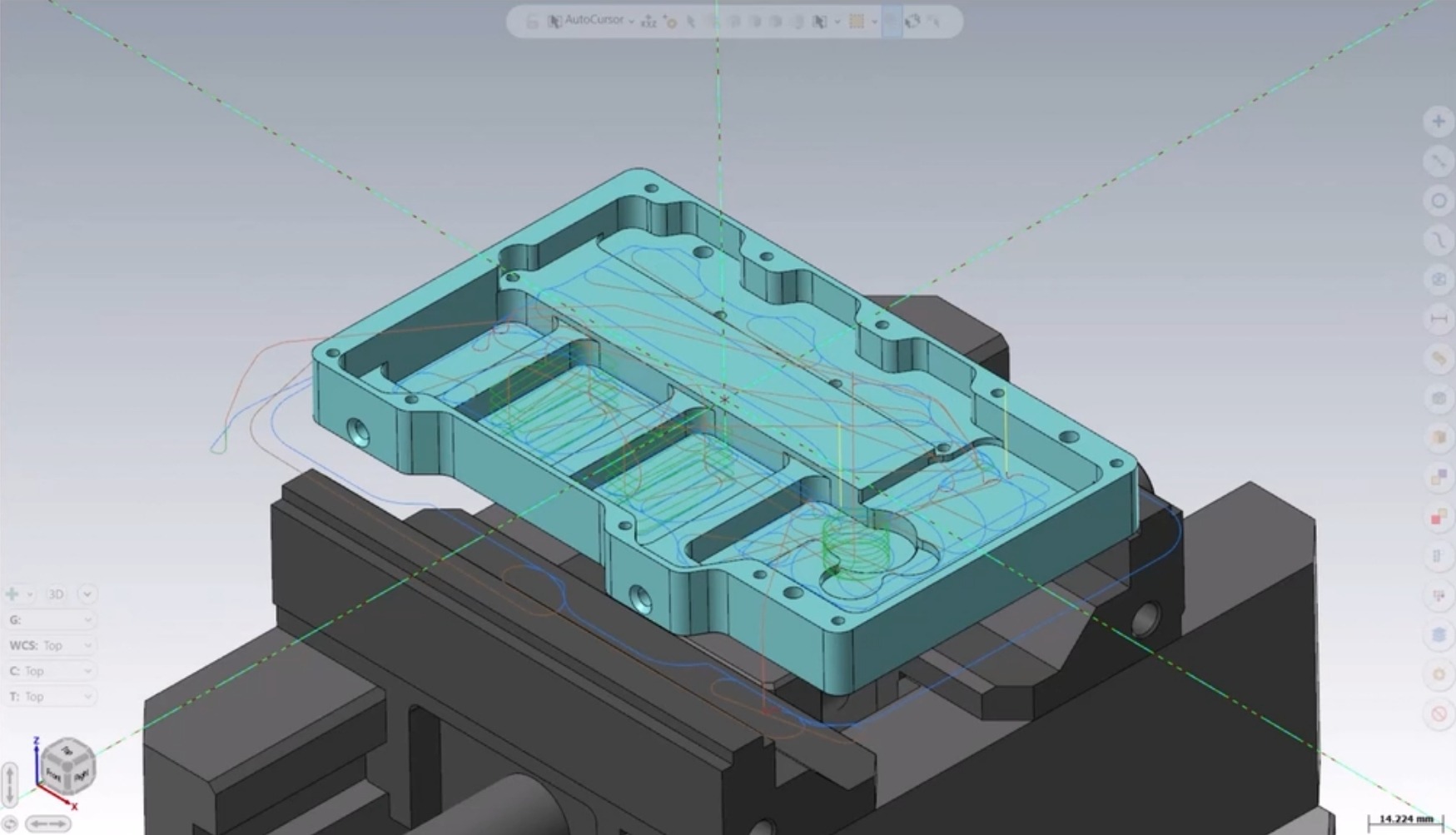

 Traditionally, a part like the one in our Show Me video requires several Dynamic Mill toolpaths to remove stock efficiently.
In the above example, the programmer used:
  • Two operations with a larger tool to rough the outer profile and the main internal area
  • Four additional operations with a smaller tool to reach deep pockets and tight features
The result is perfectly functional, but the programming time adds up quickly when each region requires its own chain, linking settings, and verification. Luckily, OptiRough offers a more streamlined alternative.
Let OptiRough Do the Heavy Lifting
Unlike strategies that rely solely on chains, OptiRough is model‑aware. This means you can simply provide the part model, and the toolpath automatically determines where the tool can fit and how it should engage.
Here is how the workflow changes:
  1. Start with a single OptiRough operation using the larger tool.
  1. Create a stock model from that operation.
  1. Duplicate the OptiRough toolpath.
  1. Swap the tool for a smaller one.
  1. Enable rest material, selecting “One other operation,” and reference the stock model.
  1. Update Steep/Shallow and minimum depth settings to control where cutting should begin.
Because OptiRough is stock‑aware, the second toolpath only cuts where material remains. No unnecessary motion. No manual chaining. No time wasted!

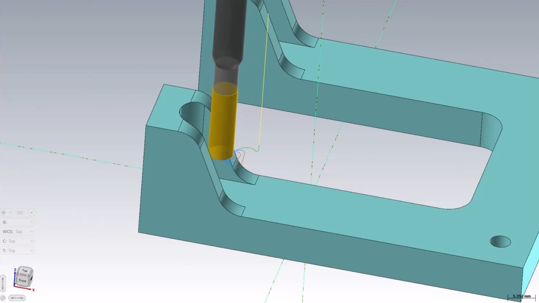

Now for a more challenging example: an open slot with a sloped stock wall on one side.
Using Dynamic Mill here is possible, but not ideal. Since the chain is based on the bottom of the geometry, depth cuts become an issue; especially when the tool cannot handle the full depth in one pass.
Breaking the cut into multiple passes introduces:
  • Extra transverse moves
  • Air‑cutting
  • Wasted cycle time
In high‑volume environments, this can add up quickly. OptiRough handles this more intelligently.
By driving the toolpath from a stock model, OptiRough trims out motion that does not actively engage remaining material. The result closely resembles Dynamic Mill, but with significantly less non‑cutting movement.
