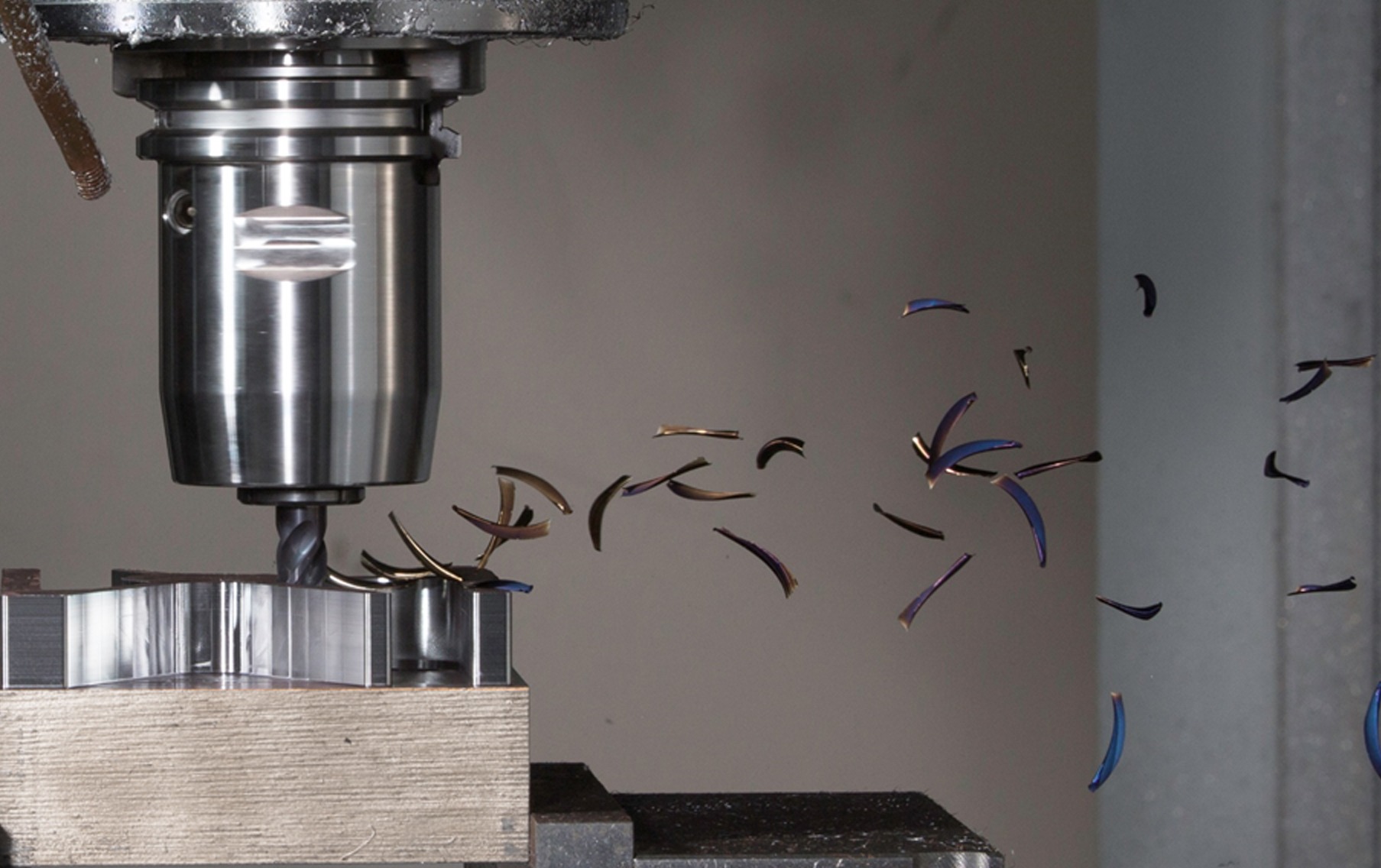

Introducing HREM: Heavy Radial Efficiency Machining
HREM (Heavy Radial Efficiency Machining) flips the traditional high‑efficiency model on its head.
Instead of maximizing surface speed and minimizing radial engagement, HREM focuses on:
  • Reducing surface speed to control heat
  • Increasing radial engagement (often 15–25%)
  • Using Dynamic Motion to maintain constant chip thickness
The goal is not aggression for its own sake. It is balance by putting heat into the chip, not the tool, while stabilizing the cutter with more consistent engagement. As Don put it: “Go slower to go faster.”
The results: Real data, real gains
To validate the approach, Jesse and Don ran controlled tests in titanium at Harvey Performance’s Innovation Lab in Maine.
Baseline strategy (traditional HEM)
  • ~6% radial engagement
  • Higher surface speed
  • Cycle time: ~16 minutes
  • Early signs of built‑up edge and floor burnishing
HREM strategy (Dynamic Motion + heavy radial)
  • ~25% radial engagement
  • Reduced surface speed
  • Cycle time: just over 14 minutes
  • Cleaner floor finish
  • Significantly reduced built‑up edge under magnification
Same material removal rate and amount of material removed. Less heat. Fewer passes. Better tool stability.
