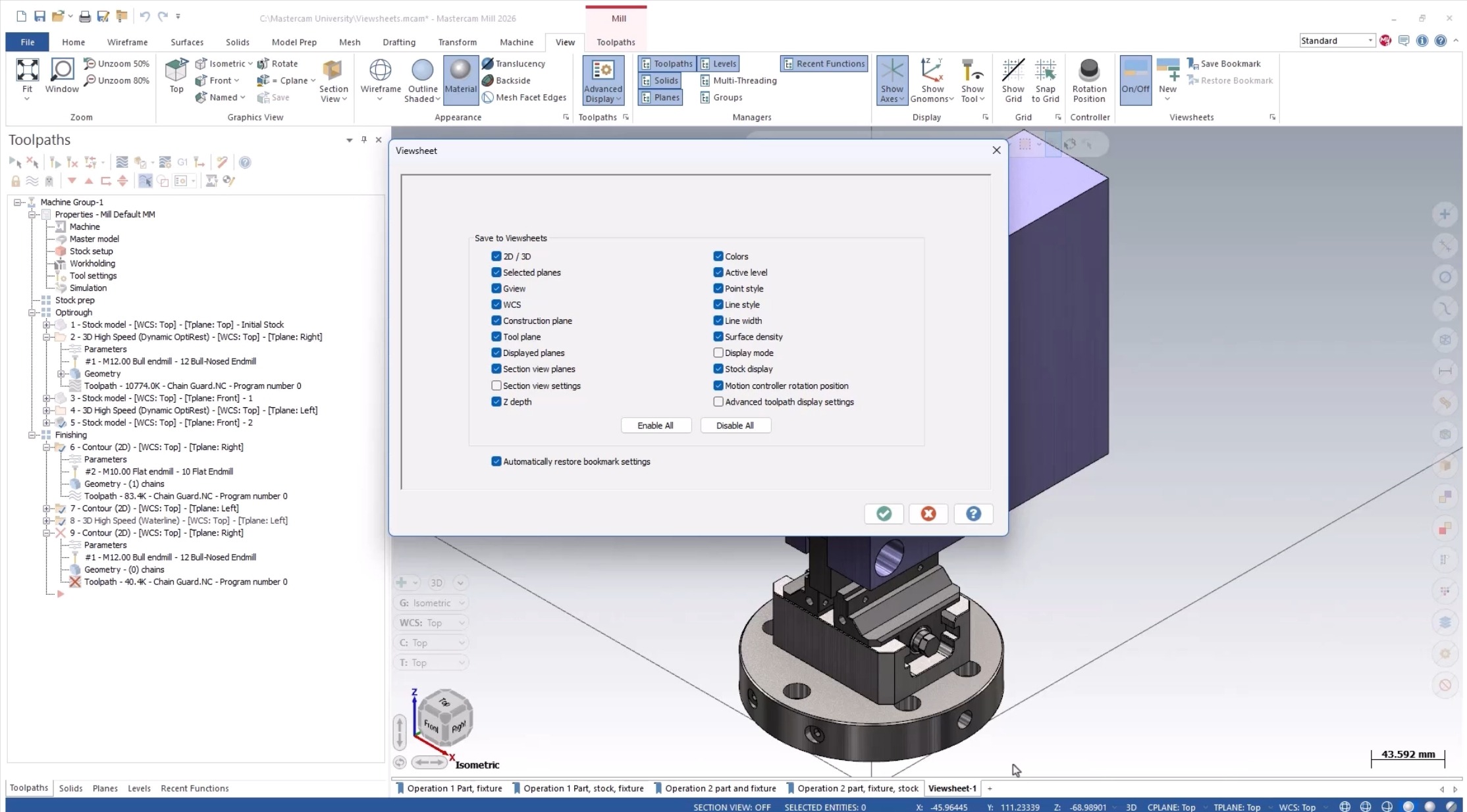

Viewsheets: Save Your Setup & Your Sanity
Viewsheets are one of the most under‑used and most powerful tools in Mastercam.
Think of viewsheets as snapshots of your workspace. They allow you to save and recall a wide range of settings, including:
  • Levels and colors
  • Planes and views
  • Rotation controller point settings
Instead of manually resetting your environment every time you switch tasks, viewsheets let you return to a known, trusted setup instantly.
How to use them:
  1. Turn on Viewsheets from the View tab.
  1. Click the plus (+) button to create a new viewsheet.
  1. Right‑click a viewsheet to save a bookmark of your current settings.
  1. Use Viewsheet Settings to control exactly what gets saved.
The result? Less setup time, fewer mistakes, and a more predictable workflow, especially on complex parts.

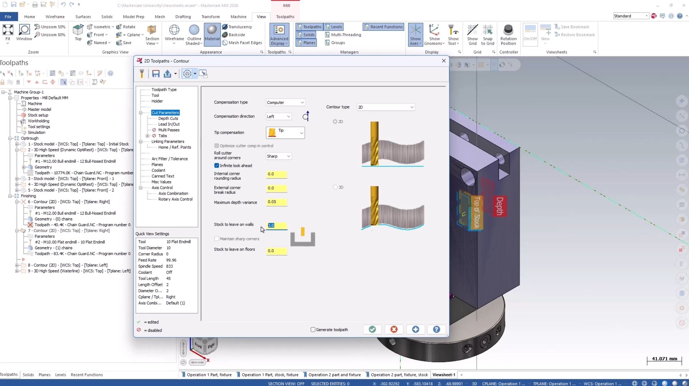

Yellow Fields Are More Powerful Than They Look
Ever notice certain fields in Mastercam highlighted in yellow? These are calculable fields, and they are doing more than just accepting numbers. Right‑click one of these fields and you will unlock:
  • Selection options
  • Built‑in math
  • Unit conversions
For example, even in a metric file, you can type 1/8in, press Enter, and Mastercam will automatically convert it to metric. No calculator. No guesswork. Just faster, more flexible input exactly when you need it.
