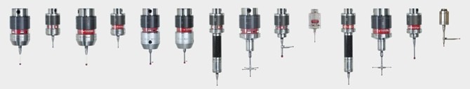

Inside BLUM: Probing Built for the Machine Tool Environment
BLUM-Novotest brings decades of machine-tool-focused engineering to CNC measurement. Founded in Germany in the late 1960s and operating in the U.S. since 1997, BLUM designs probing solutions specifically for the realities of the shop floor: coolant, vibration, temperature changes, and high-speed motion.
What Makes BLUM Probes Different?
  • High-speed probing with minimal cycle-time impact
  • Optoelectronic measuring mechanisms (not mechanical switches) for long-term accuracy and durability
  • Non-lobbing, rotation-symmetric design for consistent results in any probing direction
  • Coolant-on probing with IP68-rated protection
BLUM also offers specialty probes for advanced applications, including contour scanning and in-process surface roughness measurement. These capabilities are typically difficult or impractical to achieve with offline inspection.

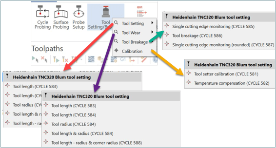

New in Mastercam 2026.R2: BLUM Laser Tool Center Support
One of the most exciting updates discussed in the webinar is new support for BLUM’s Digital LC laser tool measurement systems in Mastercam 2026.R2
Unlike traditional laser systems that capture a single measurement, BLUM’s digital technology combines analog and digital data, collecting thousands of data points as the tool passes through the beam.
What Shops Can Do with Digital Laser Measurement
  • Measure tool length, radius, wear, and breakage
  • Scan tool contours, including ball and corner radii
  • Optimize tool offsets based on actual cutting conditions
  • Detect vibration and spindle health issues before cutting
All of this data integrates seamlessly into the Mastercam Probing workflow, bringing advanced tool insight directly into the program.
