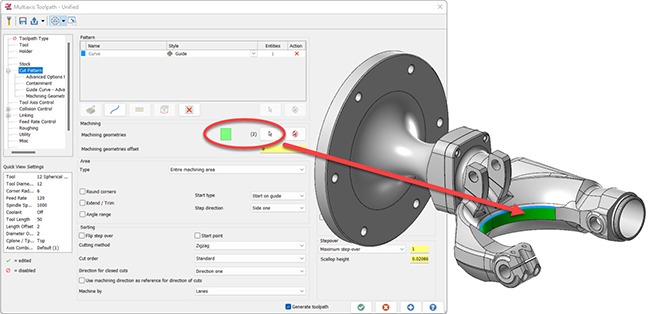

Colored Selection Display Multiaxis
In Mastercam 2024, many geometry selections are now viewable in the graphics screen immediately upon entering a multiaxis path. Things like Machining geometries, Collision Control selections, and Pattern entities are colored and presented to the user depending on the page they are on and the preview control settings they’ve chosen. Similar to 3D HST geometry selection, all non-selected surfaces are colored in the white “remainder” color.
Users do not have to enter the selection step of a specific area of the toolpath to understand what selections the toolpath is using to calculate with. All selections are color-coded with the type of selection and presented all at once on the graphics window while the user is editing a toolpath, reducing time going in and out of selections to verify proper selection.

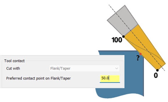

Deburr Enhancements
Last year, Mastercam 2023 introduced the ability to cut with the flank of the tool. For Mastercam 2024, those controls are now consolidated into a drop-down menu where the user chooses whether to cut with the tip or the flank of the tool. If the user chooses to cut with the flank, the percentage option will appear. With this option, you can now specify the contact percentage along the flute.
