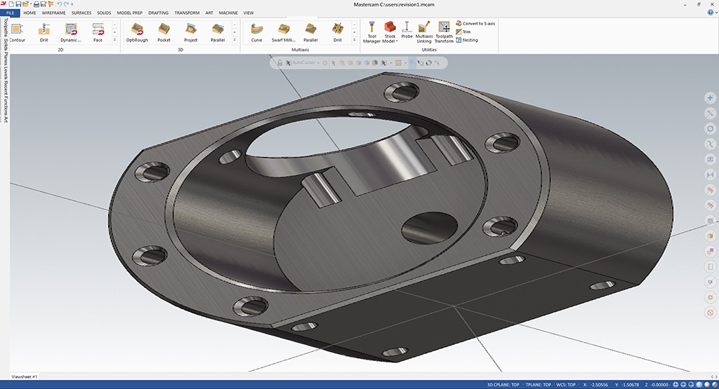

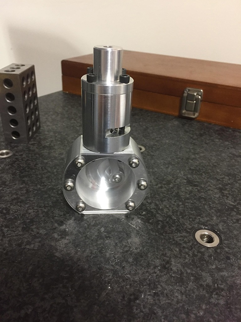

Mastercam’s ease of use is a huge benefit for Lincoln students, especially when they work on special projects. A hand-cranked air compressor was one such project. The compressor is comprised of several parts, including a handle and feet, with tight tolerances on the internal components. In addition to ease of use, students benefit from the intuitive features of the CAM software.
“One thing that stands out is plane control and creation,” said Long. “I like the way the Mastercam environment allows us to identify different planes to machine from to get that level of control.”

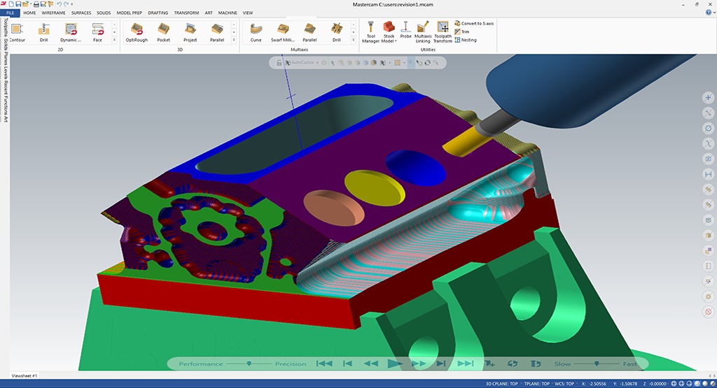

Mastercam for the Mill covers program use and functions, drawing tools, and Dynamic Motion toolpaths. From optimized pocketing to highly specialized toolpaths, with Mastercam Mill, parts are produced faster and with greater accuracy, quality, and reliability.

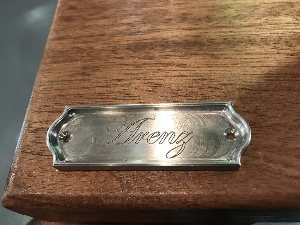

Lincoln students appreciate the intuitive aspect of the CAM software and have a favorite feature: Raster to Vector. Located under the Wireframe tab, the feature allows the user to pull an image into Mastercam and create geometry from it. To better engage his students, Long uses the software features in creative ways throughout his courses. He challenged one group to cut metal parts and engrave their signatures on them.
Excited by the prospect of personalization, the students signed their names on pieces of paper, photographed the signatures, and pulled the images into Mastercam via Raster to Vector. The software then generated geometry from the images. Students programmed the machines and, within minutes, machined their signatures onto parts.

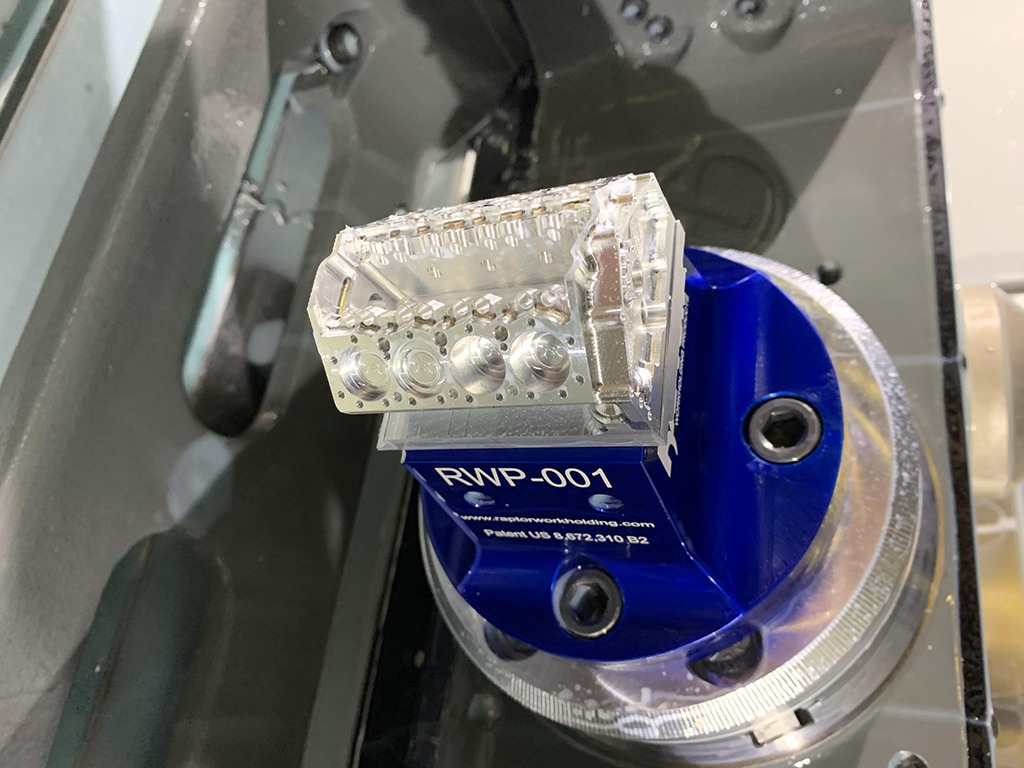

The Advanced Multiaxis Machining class begins with live tooling lathes and programming them in Mastercam. Students set up and run a few different parts before moving on to 4-axis programming and 5-axis programming and machining.
“For programming, we use Mastercam because trying to program 5-axis longhand—it’s not impossible, just foolish,” said Long. “Why would you longhand something like that when Mastercam exists?”
