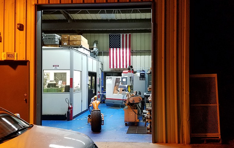

Green is the sole mechanical designer and instrument maker for the 3.6-meter telescope on the summit of Maunakea, a dormant volcano. He can be found in a back building of the headquarters in Kamula, where a machine shop houses one CNC vertical machining center and several manual tools, including Bridgeport Mills, lathes, and surface grinders.

The machine shop houses one 3-axis 1999 Cincinnati Arrow 500 CNC vertical machining center. Green machines parts such as camera bodies and heat exchangers using mostly aluminum with some stainless steel, titanium, and Invar, an iron-nickel alloy.

The machine shop includes manual tools and one CNC machining center.
“Having in-house machining is a rarity,” he said. “Our engineers come up with very creative solutions to make our instruments better and, usually, I can implement them that same day. We go through this process of testing, redesigning, and making new components constantly and we eventually arrive at something that works very well.”

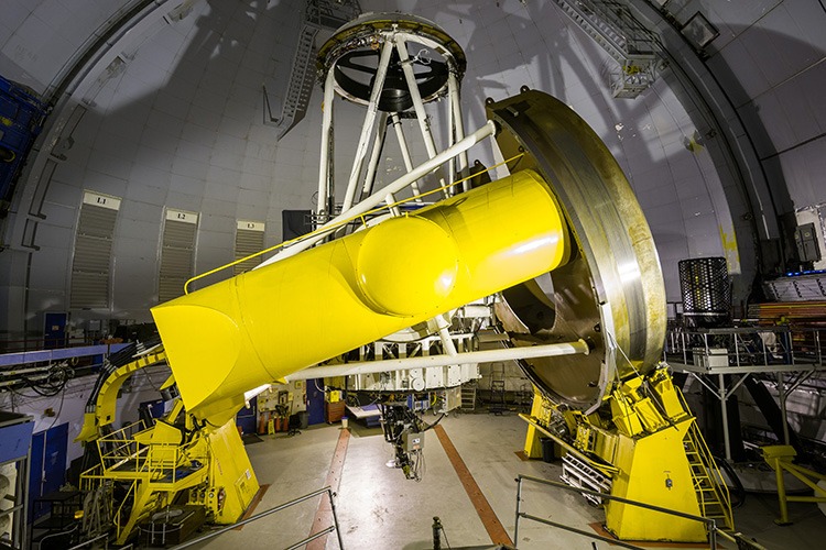

Instruments at the observatory are supercooled to 70 K, or -334°F, to improve the signal-to-noise ratio. Located 60 miles away, the machine shop is at a significantly lower altitude with warmer temperatures around 75°F. Components must effectively perform with large thermal variations, as well as maintain tight tolerances measured in angstroms, or a hundred-millionth of a centimeter.
“When tracking something that moves across the sky—an asteroid flying past the Earth or a whole other galaxy—our telescope moves at the rate that the object moves across the sky,” Green said. “You can imagine that things get a little fussy.”

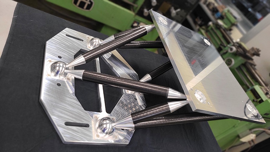

One of the more challenging projects for Green was creating the structural components for a small astrometric camera that drives the big telescope, similar to a sight on a gun.
Some components were so large, they required four different machine setups.
Green added holes to the design, allowing him to connect the part to a surface plate with dowel pins. He then indexed the part on the fixture to access the different areas for machining.
The finished structure included carbon fiber tubes bonded to an aluminum end and bolted to a semi-sphere joint.
Astrometric camera mount, machined with Mastercam.
Machining accuracy is critical. Any mistakes would be costly, requiring additional materials and shipping time. Most resources are only available from the mainland, including repair services.
Since each part is unique, Green uses simulation to prove programming accuracy.  “The Verify feature in the software is priceless,” he said. “I know my post that spits out the G-code is reliable and what I see on the screen is what’s going to happen on my machine, so I don’t have to scrap something that I’ve been working on for a month.”
