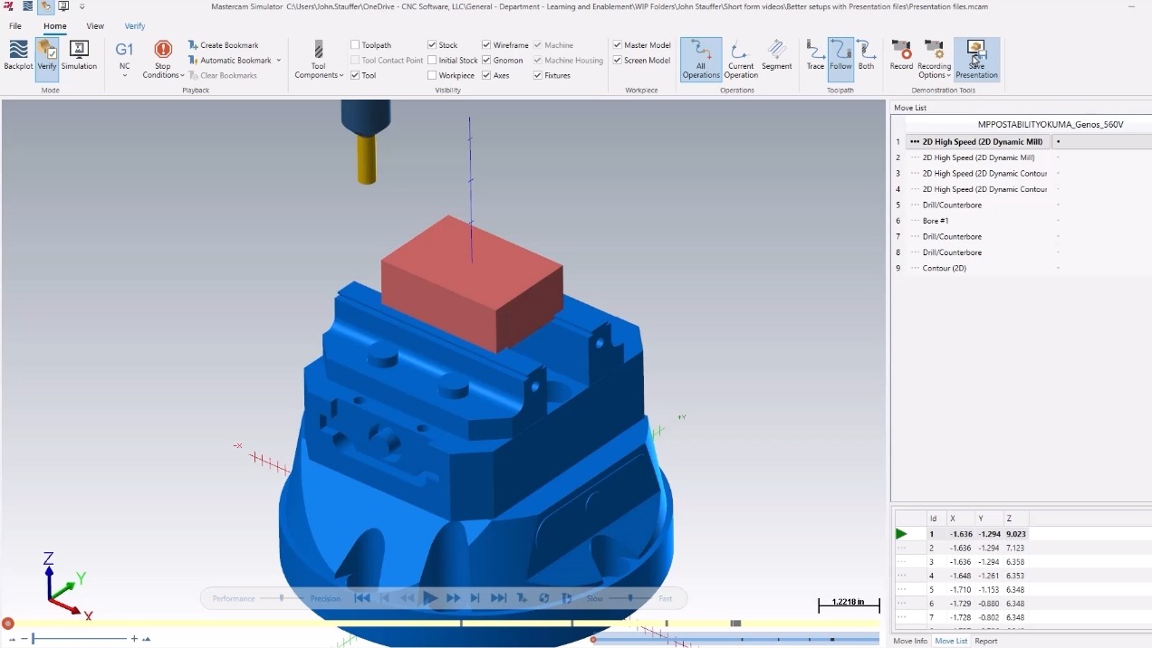

 A Mastercam presentation file allows machinists to view a simulation of the programmed toolpaths directly on the shop floor using any standard Windows computer.
Presentation files are saved as standard EXE files, making them easy to open with a simple double click. Once launched, a Verify window appears with all the familiar visualization tools machinists already know.
What they can do:
  • Watch the program run step by step
  • See how tools enter and exit the cut
  • Verify the relationship between stock, part, and workholding
  • Build confidence before the first cycle start

  • Open your program in Verify
  • From the Home tab, select Save Presentation
  • Choose where to save the file
  • Name the file clearly (use a job number or part number and include operation identifier when possible)
  • Save the file
That’s it. The presentation file is now ready to be opened on any compatible Windows-based machine, no Mastercam installation required.
