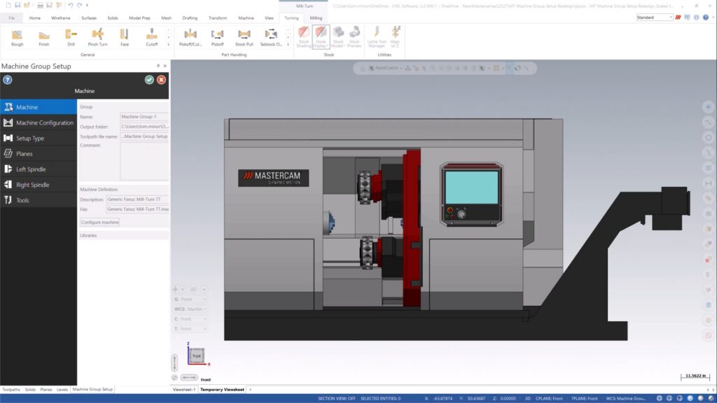

1. Saving and Loading Machine Configurations
In Mastercam 2025, Mill-Turn users now have the capability to save unique machine configurations into individual files, streamlining setup for new projects. This advancement is super useful when processing families of parts or when you have tools and fixturing that rarely leave the machine.
Your configuration file can be stored anywhere on your workstation! Power users can store the configuration right in the Mill-Turn’s respective .machine file under the “Machine Configuration” files node.
