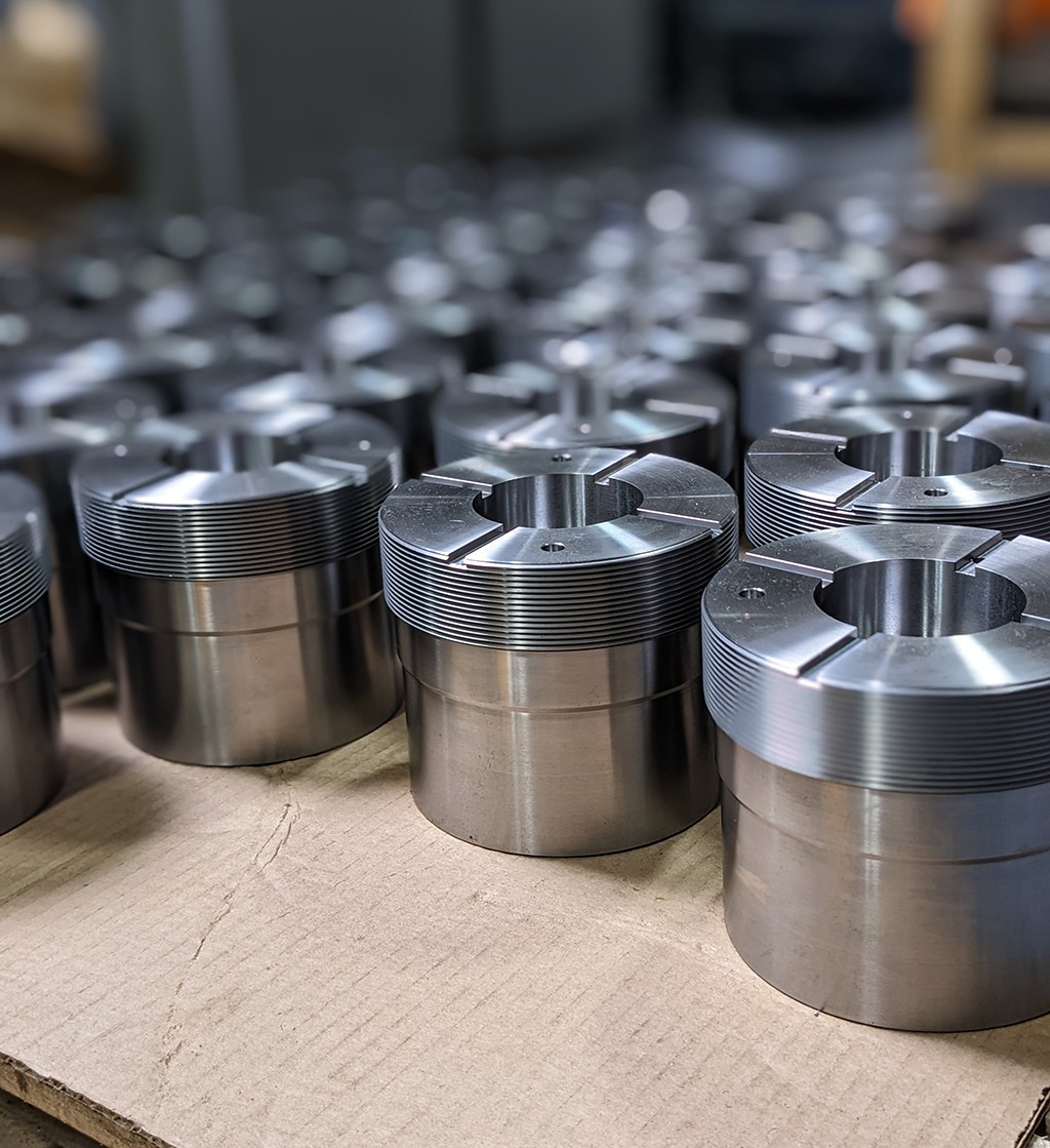

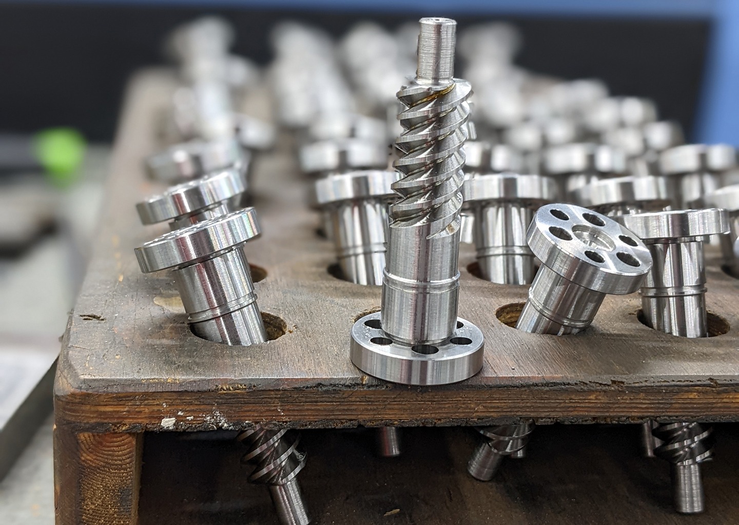

Close up of finished parts

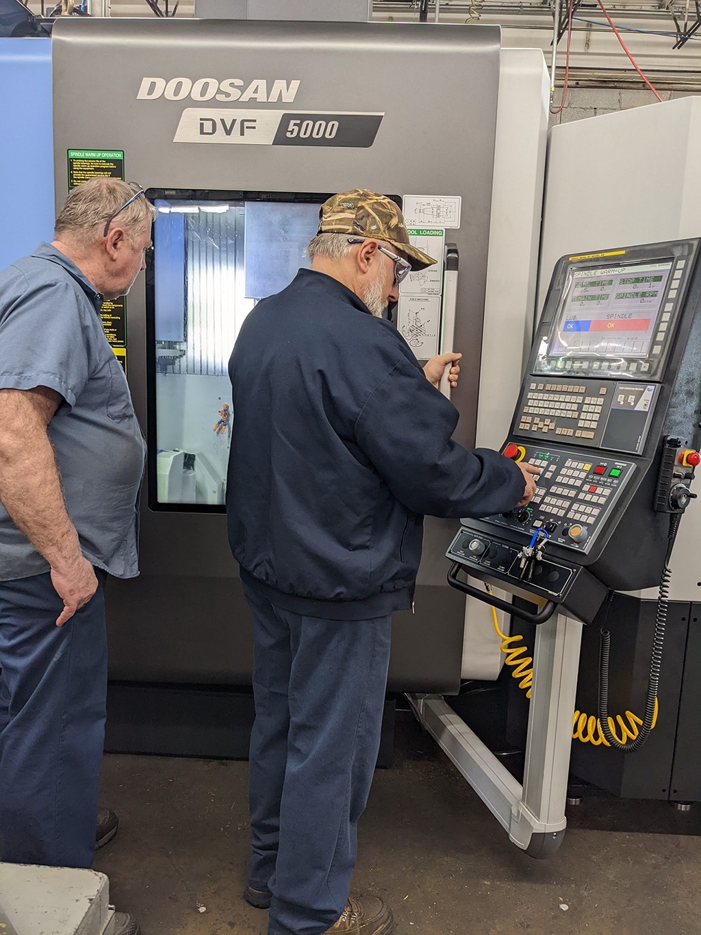

The standardization of CAD and CAM software allowed operations to be streamlined throughout both facilities. Whether a part was initially run on the Doosan or Okuma machines, programmers now have the ability to change equipment as needed based on customer demand. With frequent schedule changes, workflow scheduling is distributed more efficiently for each department
Programming a part on the Doosan machine.

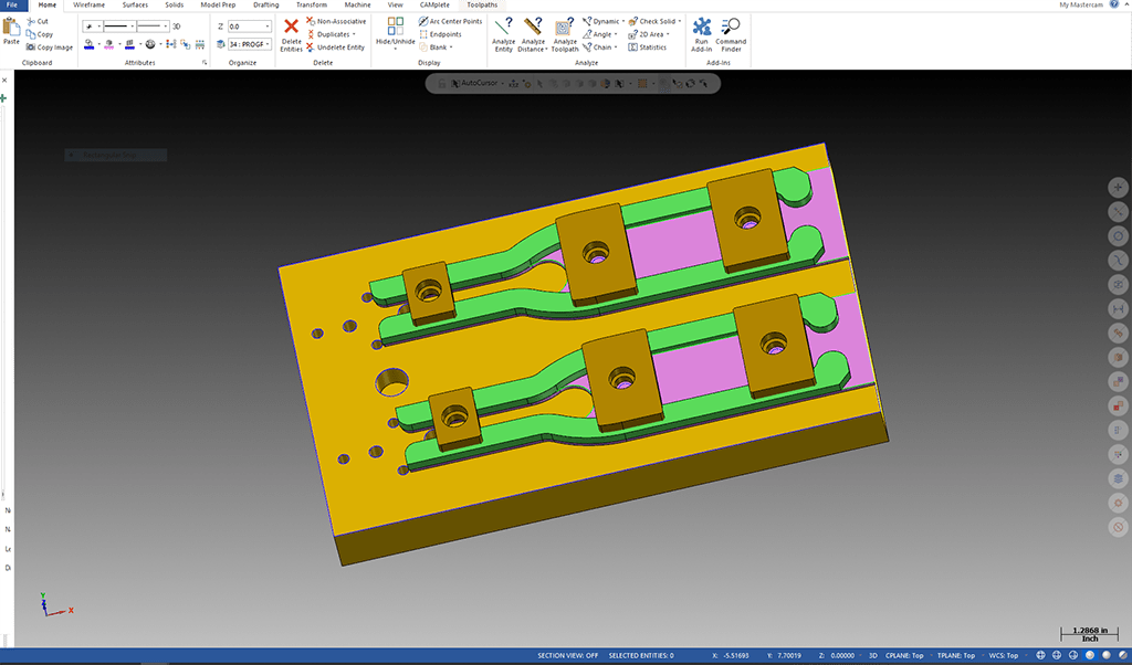

The engineers and programmers assessed the rack’s current production methods and found that the rack was being held in a simple plate fixture. The cycle time was roughly two minutes before it would be manually flipped by an operator, repeating two times. Including the time required for part changes, the operation had more downtime than uptime.
A custom fixture for a rack.
To make the rack cost effective, the team designed a fixture in SOLIDWORKS (Dassault Systèmes, Velizy-Villacoublay, France) that could hold eight workpieces at once. The part was clamped to an island with the ends overhanging, allowing the part to be suspended and machined on both the top and bottom sides, without having to be flipped. The solid model was imported into Mastercam where the 2D Dynamic Contour toolpath ensured the proper chip load. The whole fixture was machined on one end mill, with one tool completing the majority of the work.
The setup time for the rack was successfully reduced to a single process, letting the machine run more effectively. The output changed substantially, increasing from 12 parts per hour to 40 to 45 parts per hour

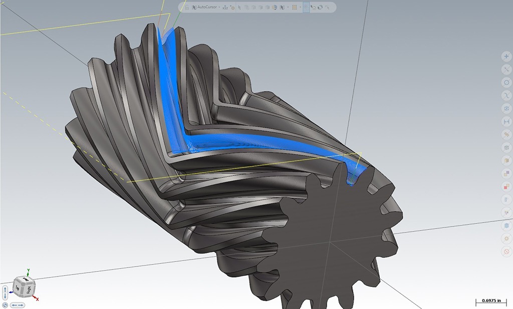

Complex gear with staggered herringbone teeth.
Looking forward to potential growth, Avers increased its capabilities to manufacture complicated geometries by upgrading to 5-axis machining. The company uses the Maintenance Program through its Mastercam Representative ShopWare Inc. (Elgin, IL) to help keep up with the latest technology. Employees have access to the most up-to-date software versions, as well as new features, and can call a ShopWare helpline if any assistance is required.

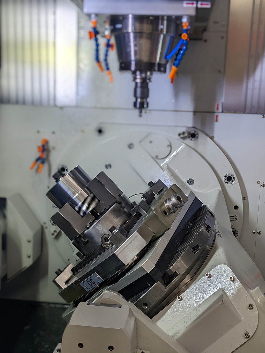

Blanks in line for 5-axis milling process.
