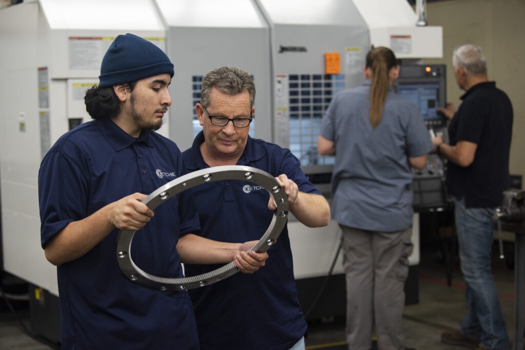

Thorpe uses Mastercam and 3D toolpaths to help reduce cycle times.
