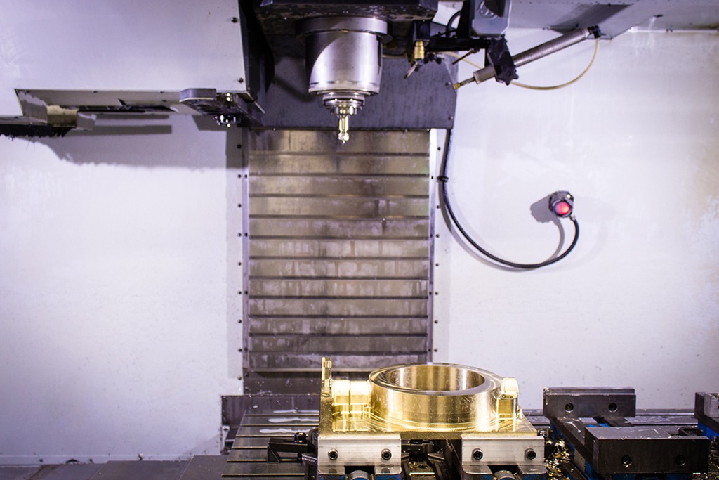

![Naval valve on machine](https://www.mastercam.com/wp-content/uploads/2023/04/Naval-valve-on-machine.jpeg)
In order to get this part to the customer in two weeks, they performed model drafting using Mastercam’s Model Prep function, printing, and then running the actual toolpath itself. They broke the toolpaths into pieces and parts and put them back together again to see the whole. “We can build our stock models from raw materials and then we can take stuff off or add it as needed.”
Kaspar reflected on the time savings, “The quicker cuts get the job done faster. Generally, depending on a number of things, the right cut can save you a tremendous amount of time as well as tool life. We can plunge with the pocket and use the other three quarters length of the end mill instead of one quarter length which is essentially getting to the bottom. Time saving is the number one reason for us diving into the trickier cuts.”
For this operation they programmed the OptiRough toolpaths which use Dynamic Motion, but in a more precise way. The cut uses the entire flute length of the tool, but a small percentage of the tool’s diameter on the first cut, followed by several successive shorter cuts that bring the part into the net shape desired.

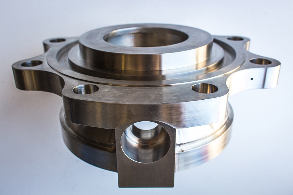

![An example of a stainless steel part, cut with Mastercam](https://www.mastercam.com/wp-content/uploads/2023/04/Example-part-cut-with-Mastercam.jpeg)
The result of being able to cut so deeply is the ability to push the machines. At times, Kaspar and crew can run the machines at 11,000 RPM spindle speed.
