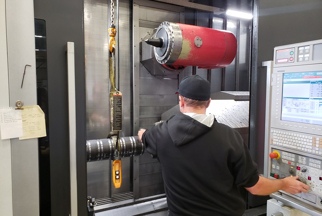

“We’d prep the piece in the manual lathe, then put it into our 2-axis lathe to turn, then load it into the horizontal to do the milling and drill work on either end. Start-to-finish, the process took about four hours,” said Schmidt. Now, they perform a quick prep in the 2-axis lathe and load the material into the mill-turn machine, support it with the tail stock and finish machining. They removed approximately 148 lbs. of material in around 20 minutes, starting with stock measuring 9.5” in diameter at 25” length, bringing the diameter down to just under 8”, turning that 8” diameter 23.25” down the length of the part.
“We ran it at an SFM of 800 or 381 revolutions-per-minute and a chip load of 0.030 inch per revolution with a depth of cut of 0.090 inch. When finishing we ran it at 477 RPM at 0.030 inch depth of cut and 0.015 inch IPM for the finish pass.” It takes them just over one hour to complete the entire process.
