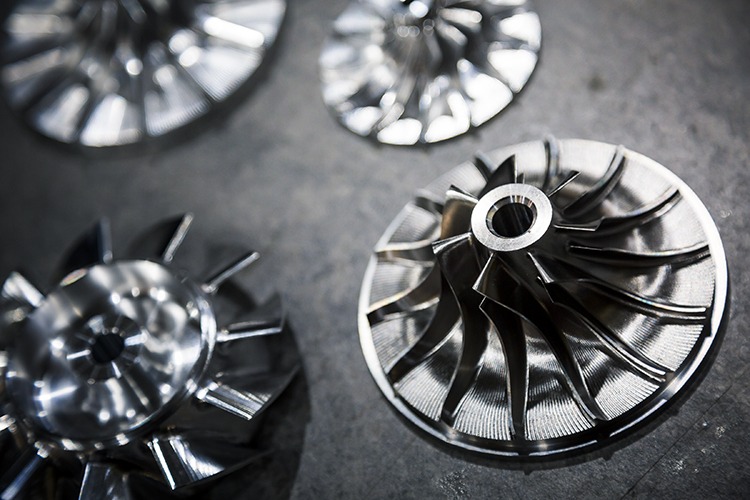

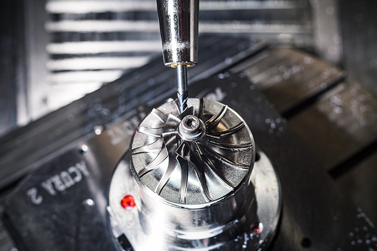

![Finish passes on Titanium wheel compressor](https://www.mastercam.com/wp-content/uploads/2023/04/FGPS5.jpeg)

“We took the plunge into full 5-axis machining 20 years ago,” said Griffiths-Hughes. “We needed something to compliment the capability of our 5-axis machine. Mastercam was the right package to support our journey.”
A few years ago, a customer approached the FGP engineering team about machining turbines. The manufacturer agreed to take on the job, but initial part programming time was extensive. The company needed CAD/CAM software that could fully support turbine machining. FGP Systems chose Mastercam Blade Expert, a software interface that provides a comprehensive solution for various blade configurations and follows the Mastercam standard used by all multiaxis toolpaths, ensuring a short learning curve and successful deployment.

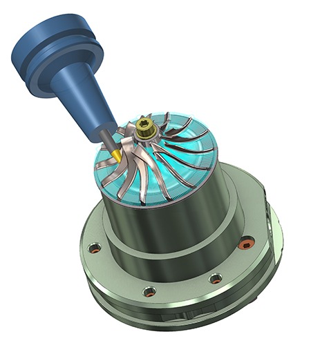

![Screenshot of 3D model of wheel compressor](https://www.mastercam.com/wp-content/uploads/2023/04/FGPS7B.jpeg)
According to Griffiths-Hughes, once one turbine is manufactured, the turbines that follow tend to be similar; the challenge lies in effectively machining the gap between the blades. The main blade, splitter blade, depth of cut, and machining strategy vary, but Blade Expert provides the ability to bear those toolpath strategies to metal. It controls depth of cut, root radiuses, and stock removal. As the billet form is machined, a stereolithography (STL) file background is created and stock removal is closely monitored.

![Silver metal turbine/impellor fans](https://www.mastercam.com/wp-content/uploads/2023/04/FGPS14.jpeg)
Embracing multiaxis machining allows FGP Systems to take on challenging parts and expand its customer base, he added. “If we didn’t have the full advantage of the 5-axis machining and the supporting CAD/CAM package, we wouldn’t have been successful.”
