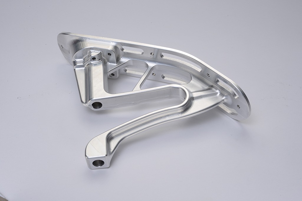

![Silver metal Funny Car latch](https://www.mastercam.com/wp-content/uploads/2023/04/Funny-Car-Body-Latch.jpeg)
DSR has found manufacturing success in a combination of advanced machines, expert technical support, and powerful software. The DSR shop holds 22 CNC machines, which include horizontal 4-axis milling centers, 5-axis milling centers, 7-axis mill-turn machines, 3-axis lathes, vertical milling centers, and a Swiss screw machine. A shop of this caliber requires technical support of the same quality. That’s why DSR relies on their official Mastercam Reseller, ShopWare, Inc. when they run into issues.

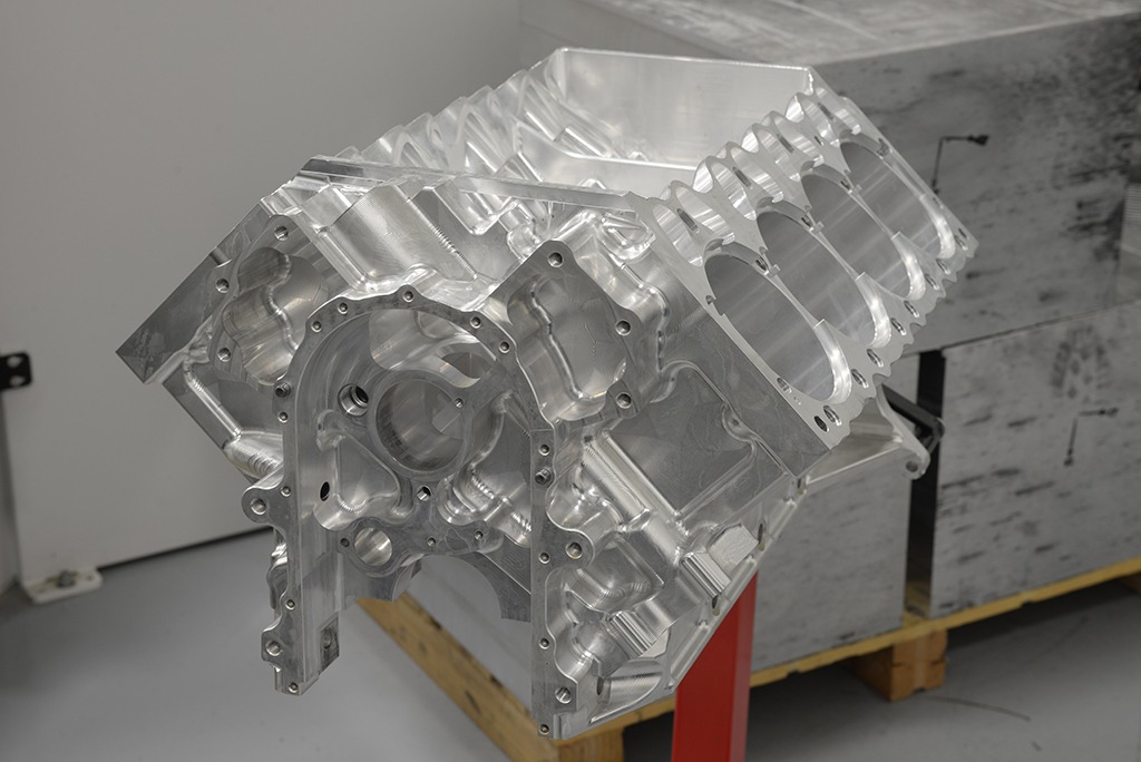

![Silver metal DSR Nitro Engine Block](https://www.mastercam.com/wp-content/uploads/2023/04/DSR-Nitro-Engine-Block.jpeg)
One such issue that DSR faces is that of part durability. “We need to make the parts light, but at the same time, we need to make the parts strong and durable. You know, these cars are going at high rates of speed, and a lot of things are happening, so safety’s a big concern. In top-fuel racing, we’re in the most extreme conditions. We make the most horsepower in any form of racing, and we run for the shortest amount of time; we’re basically building a controlled bomb,” Cutler explained.
When DSR sends out their racing team, they need to be sure that they can come as close to guaranteeing their safety as possible. “Mass will always help you in durability, but it doesn’t help you in increasing speed or reducing overall weight. It’s one of the hardest things to do because we can’t use heavy metals like we should, so we have to use a weaker metal but somehow we have to make it hang on to the most power.”
DSR often uses aluminum and mild steel. Each part is contoured, which adds ribbing to areas that will be under higher stress while removing excess weight from other spots. To strike the perfect balance between safety and speed, DSR’s design and modeling process need to be extremely precise.

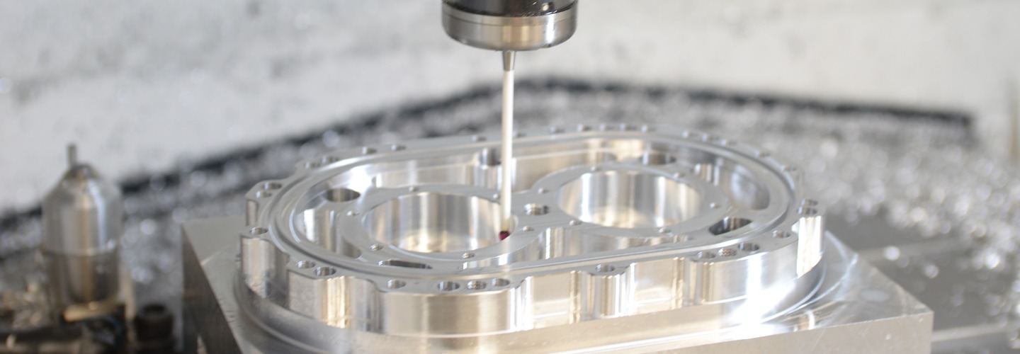

“We have a Tool Library created for basically each category of machine. We constantly import Sandvik’s tooling models. It helps us in simulation, and we can look at the actual tool holder to look for interference there and not just on the cutter.”
Cutler then turns to the Compare feature within the Simulation tool to compare solid models, visualize the accuracy of the cuts, and check for any collisions. “It’s given us a lot more flexibility in working with solids when we get into a lot of our complex parts because everything is 3D. We can now go and write in through the software and manipulate it to get us the result we need.”
