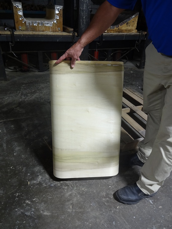

According to the patent, which was awarded in 1975, cold-pressing involves taking “one innermost and two outermost veneer sheets, each having a grain and two major surface areas.” A coating of polyvinyl acetate is applied to both major surfaces of the innermost sheets and one of the major surfaces of both of the outermost sheets. After assembling the sheets in a pile, they are pressed into a consolidated composite at room temperature. Part of one of the pressing surfaces is curved. The sheets are pressed for 18 minutes resulting in plywood sheets that are resistant to cracking and splitting during conventional machining processes.

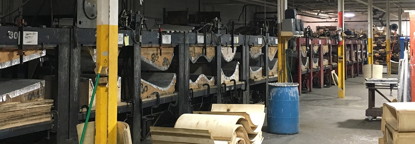

The shop also has a 3-axis router, six radiofrequency machines, and rows of cold press machines. In recent years, Keith has witnessed a shift in the furniture making business in that the contours and shapes of the furniture are becoming more detailed and varied, requiring different cutting and boring operations.
