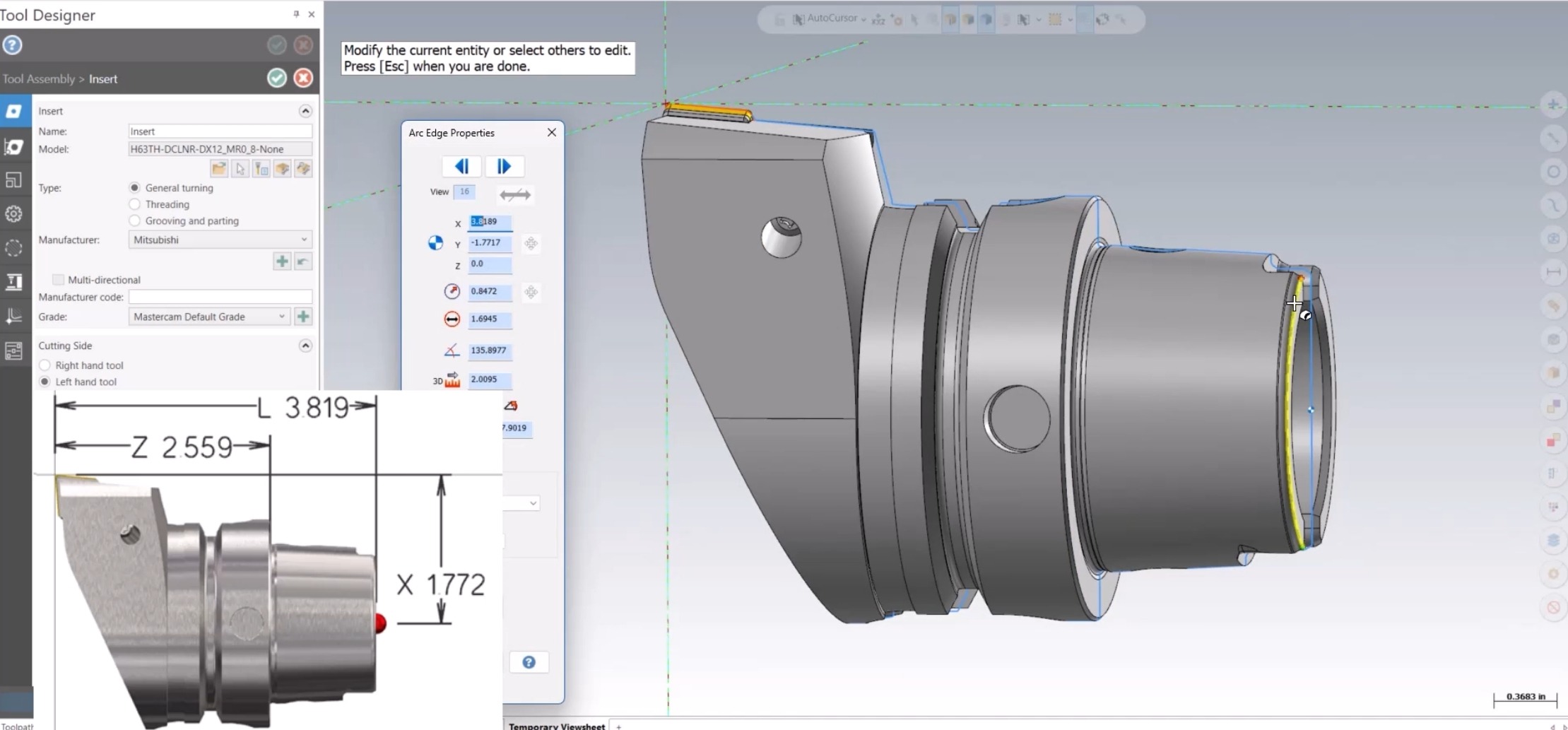

Step 2: Determine the correct X, Y, Z, and L offsets
To find the correct values for the Manufacturer code field, you will use Mastercam’s Analyze Entity tool. These offsets are based on the image Mastercam uses internally for interpreting lathe tool positioning.
A key thing to remember: The axis labels in the Analyze dialog don’t directly match the axis labels in the image.
Here is how they translate:
From Top View:
  • Analyze X → Image Z
  • Analyze Y → Image X
  • Analyze X at the back of the tool → Image L
From Front View:
  • Any centerline shift from the insert tip to the center of the tool body becomes the Y value in the Manufacturer code.
If your part file is inch-based, values will appear in inches. If it is metric, you will see millimeters.
Step 3: Enter the values into the Manufacturer code field
Once you have all four values (X, Y, Z, L), enter them in this format: X[value]Y[value]Z[value]L[value]
This string tells Mastercam exactly how to offset the tool, so it loads in the correct position during machine simulation. Save the tool, regenerate your operation, and open Simulation again. You will then see the tool correctly aligned in the spindle.
