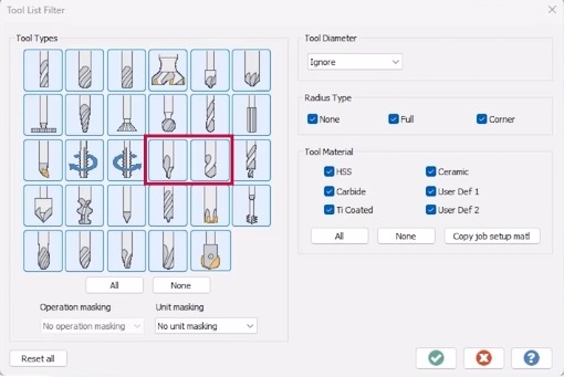

When setting up drilling operations in Mastercam, you may notice two similar tools in the filter: spot drills and center drills. While these terms are often used interchangeably, they serve very different purposes—and using the wrong one can lead to tool damagepoor hole quality, and inaccurate machining results. Let’s break down the differences and best practices for each.

Side by side, the geometry tells the story:
  • Center Drill (left): Designed for creating a divot that a lathe center can engage with.
  • Spot Drill (right): Designed to create a starting point for a twist drill, preventing drill wander and improving hole accuracy
