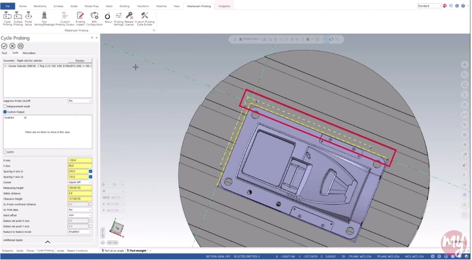

Step 1: Add a Probing Cycle
Start by adding a probing cycle to measure the angle at the back edge of your material. This data will let you rotate the WCS to match the material’s orientation.
Important: This method requires a post modification. It is a simple change your post developer can handle.
Step 2: Configure Measurement Settings
  • Enable Measurement Results in your probing cycle.
  • Turn on Deviation: X Surface Angle to capture the angle deviation.
  • Assign this deviation to a variable (e.g., variable 699 in our example).
    Note: Different probes and controllers use different variables—check your documentation.
