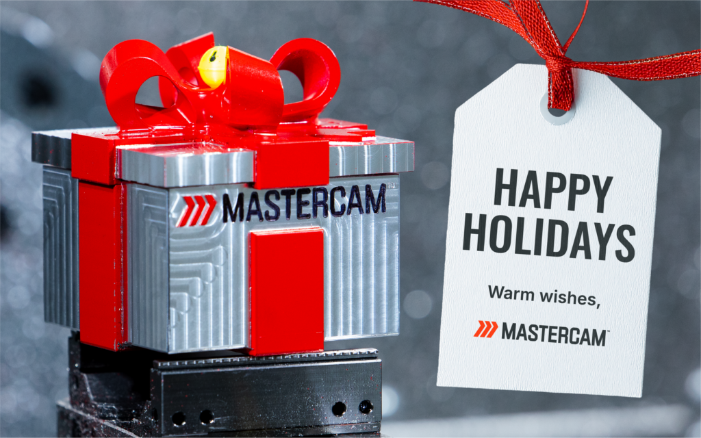

What started as a simple holiday concept quickly became a full-blown technical challenge: create a gift complete with an organically sculpted bow and removable lid, all without an existing CAD model.
The design needed to be free flowing, but still machinable, all while demonstrating cutting-edge CAM capabilities. This was not just about making something seasonal; it was about proving what is possible with advanced surfacing, multi-axis machining, and next-generation toolpaths.
Building the Gift from the Ground Up
Mastercam Applications Engineer, Tom Minor, started from scratch, modeling the present starting from a blank screen in Mastercam.
To keep the process simple, he used “historyless modeling” and tracked the design progression using groups in Mastercam’s new and improved Levels Manager. This enabled quick iterations, while preserving each iteration in case of mistakes.
How We Made It Happen
  • Setups: Five for each part, including machining, anodizing, and re-machining.
  • Fixtures: One set of custom soft jaws for each part.
  • Toolpaths: 70 were used for the lid and bow and 51 for the box. 15 toolpaths were used for one set of soft jaws and 11 for the other set.
  • Cycle Times: Approximately 1 hour and 20 minutes for the box and 3 hours and 39 minutes for the lid and bow.
  • Efficiency gains came from OptiRough, reduced shank tools, and bull mills. In the end, Minor transformed two aluminum blocks weighing 9.4 lbs. into two parts weighing 1.9 lbs. total masterpiece, removing about 7.5 lbs. of material.
  • The bell on the bow was modeled in Mastercam, saved as an STL, and 3D printed; showing that Mastercam excels at both subtractive and additive manufacturing.
