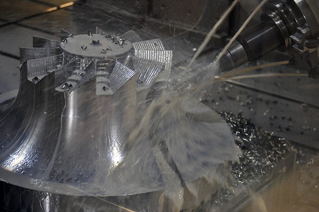

Analyze the shape of your part and – keeping in mind your cutting strategy – choose a work-holding device to best support your part and hold it in place during machining. Fixtures securely hold the stock material in a fixed location and orientation (and spin the stock, in the case of lathes and Swiss machines) so that the tool can cut accurately. The best fixtures will ensure part repeatability and the highest quality parts.
Once you’ve chosen the best option, secure your material in the fixture. Depending on your G-code, you may need to repeat this process for each operation. Be sure to use Verify, Backplot, and Simulation to check for any possible collisions or mistakes.
Run Your Program
Start your machine and watch the magic! If your program was prechecked and your material is secure in its fixture, you should be able to walk away until either the part is finished or until it needs to be re-fixtured.
