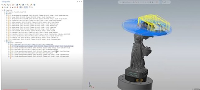

Detect Undercut Stock
Nike undercut in Mastercam
Mastercam’s OptiRough toolpath was used to kickstart the roughing phase of the statue.
In Mastercam 2023, we introduced the Detect Undercut Stock checkbox, which allows the user to trim all of the air cuts with just a single click of a box. By using this feature, the run time of the toolpath was cut by a third from 18 minutes to 12 minutes. The Detect Undercut Stock checkbox was invaluable on the Nike project because this part was full of hidden undercuts.

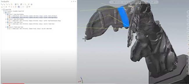

Unified Multiaxis
Nike unified in mastercam
Mastercam’s Unified Multiaxis toolpath helped finish the Nike statue as it allowed the YASDA machine to make long sweeping motions in several phases of the project, including the wings and the front of the dress. Since the statue was a mesh file, we could create a wireframe on any point of the mesh, so drive curves were created that followed the wrinkles of the dress’s curvature.
Using this as a guide curve in Unified Multiaxis, we could control the step over in a way that followed the exact contour of the dress, which made the step overs of the toolpath blend into the profile of the part.

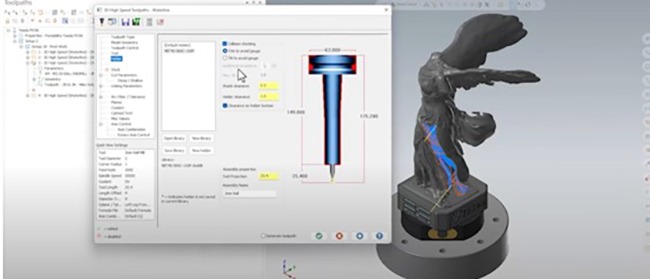

Advanced Holder Checking
Nike holder in Mastercam
When programming a part as complex as the Nike statue, it is crucial to keep our tool and holder safe. Mastercam has the ability to apply holder checking, which means we can trim our toolpath motion or create tilt motion anytime our tool holder will interfere with the part.
While working on the Nike statue, we had to keep our toolpath moving without any collisions. Mastercam’s Check Holder function allows the user to calculate a safe minimum tool projection for all of your Mill toolpaths.
