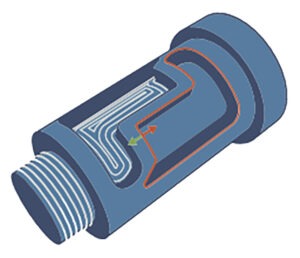

Managing Containment for Rotary Advanced
The Rotary Advanced Containment options allow you to define containment boundaries, create an offset from the boundaries, and invert containment selection results.
You have three options to configure containment:
- Containment curves: Use the arrow button to display the Solid Chaining dialog box from which you can define the containment-boundary curves, while showing the number of curves selected.
- Additional offset: Apply a toolpath offset that is relative to the containment boundary.
- Invert containment area: Switch the machining area from a region within the containment boundary to the area opposite the containment boundary.
