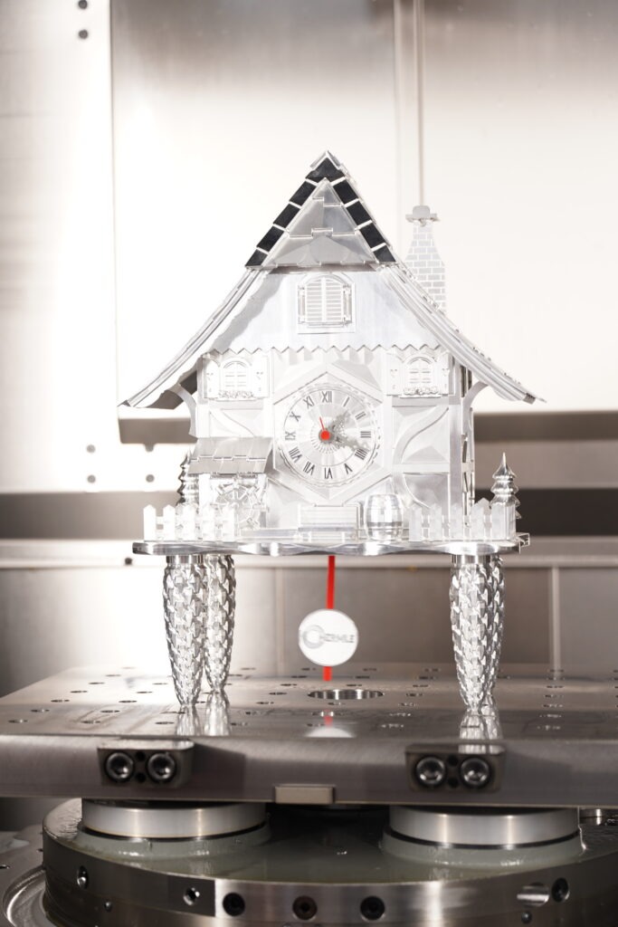

In a whimsical departure from traditional industrial applications, Mastercam, in collaboration with Hermle Machine Tools, SECO Tools, SMW Autoblock, and Vericut Verification, set out to demonstrate what’s possible by creating an extraordinarily intricate, fully machined Cuckoo Clock from a solid 300x300x160 mm block of aluminum. The finished piece will be on display at EMO 2025 conference in Hannover, Germany.

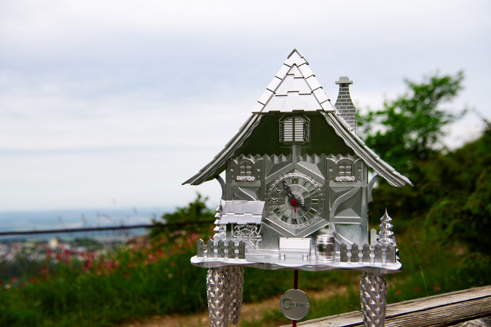

A compelling example of the evolution in precision machining is this modern reinterpretation of the traditional cuckoo clock. Through the integration of advanced programming and machining techniques, our project team set out to merge old-world craftsmanship with modern technological precision.
Even carving a wood cuckoo clock is no quick venture and can take up to three weeks to complete. Each clock is a layered masterpiece of intricate designs, painted figures and precision mechanics. Our team’s version was machined from aluminum. Call it functional art.

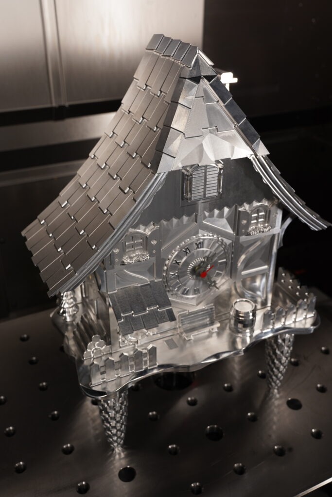

Working with Multiaxis toolpaths posed significant challenges. Selecting numerous surface facets made it difficult to define precise constraints or guide curves. As a result, the team opted to use 3D toolpaths where possible, which worked effectively on mesh geometry.
“This approach allowed us to define boundaries using wireframes and supplemental meshes, especially helpful in the initial setup to machine the walls and decorative accents beneath the roof,” said Gaetan Schnepp, Mastercam’s Project Lead. “The outcome was a clean, accurate toolpath generated with minimal effort.”
Once the foundational features were complete, the team transitioned the toolpath using the “convert to 5-axis” technique. This enabled the reuse of the existing machining pattern while focusing on three core controls: tool axis orientation, collision management, and refined linking strategies.
“Perhaps the most intricate challenge was machining the stylized trees, which were positioned beneath the roof and partially obstructed by fences,” adds Schnepp. “We preserved their mesh structure to maintain an organic aesthetic, but this introduced additional complexity. To achieve a more defined form, we used refinement techniques that enhanced surface quality.”
Using the concept of a vertically bisected cone, the team was able to isolate and access each side of the tree, machining both front and back with efficiency. The toolpath could be simplified, and collision control mechanisms enabled the tool to retract gracefully along the tree’s surface. This avoided the need for manual manipulation of tool orientation within tight valleys and protruding features.

  • Mesh Machining: Organic elements like trees beneath the clock’s roof were retained as mesh objects. Using refined 3D toolpaths, the programmer achieved accurate, clean results while preserving shape complexity.
  • Convert to 5-Axis: This feature enabled full tool orientation and collision control around difficult areas, such as machining under the roof and behind fences.
  • Clean Core Strategy: To access hidden interior features like tree bases, a vertical cone was sectioned and used to guide machining from both front and back.
  • Unified Toolpath with Guide Mode: For panels and tight surface areas, guide-based containment strategies allowed optimal passes even if standard parallel paths failed.
  • Deburr in 5-Axis: Despite the intricate nature of the part, this toolpath delivered fast, safe edge finishing thanks to accurate machine kinematic awareness and tilt angle restrictions.
  • Stock Model Planning: Toolpaths were planned and split into progressive stages, using exported mesh-based stock models to visualize material remaining and segment the job into logical units.

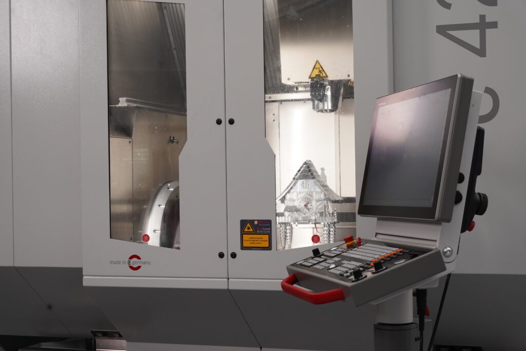

  • Total Machining Time: 47 hours
  • Material: Aluminum
  • Part Size: 300x300x160 mm
  • Machine Platform: Hermle C42series 5-axis
  • CAM Platform: Mastercam
  • Verification: Vericut
  • Tooling: SECO Tools
  • Workholding: SMW Autoblock
