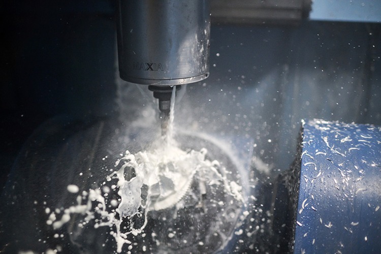

A wing on the gripper is somewhat suspended in space by a very thin gusset. Take too much off around the gusset, and the part crumples. Take too little off, and the part loses its mobility and much of its function. To safely removed the exact required amount, Huk uses his software’s Dynamic Mill toolpaths.
Dynamic Motion technology, the parent group of tools to Dynamic Mill, consists of various stock-aware machining approaches designed to intelligently remove material. Dynamic toolpaths not only calculate the absolute best angle and speed and depth at which to engage the cutting tool, they also make instant adjustments to these calculations during machining.
The shop uses Dynamic Mill toolpaths to safely remove exactly the required material.
During milling, this translates to the fastest, safest material removal possible. The Dynamic approach mills away that section of the block while it is supported and then returns to drill the precision holes. Then Huk creates a stock model within the toolpaths group.

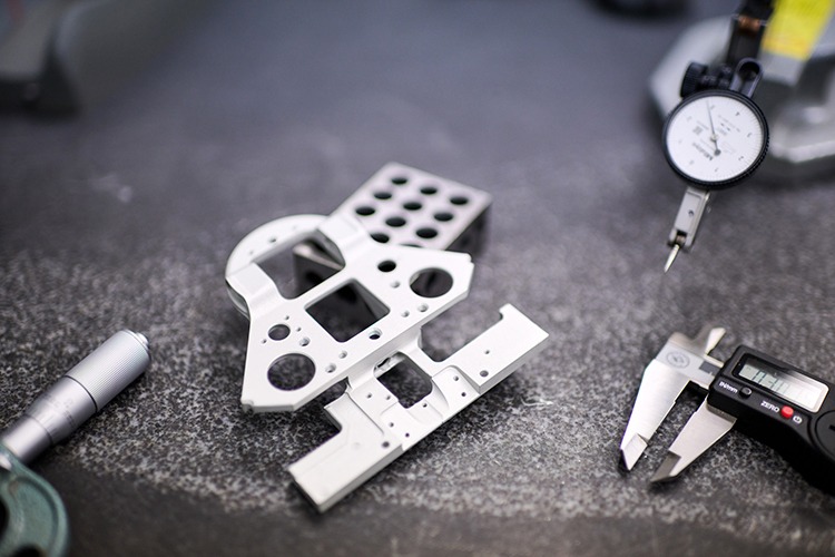

Big Drum’s customers demand parts of the highest precision.
The stock model keeps operations tied to a 3D model, and it makes it easy for Huk to apply consecutive Dynamic toolpaths in various reorientations and view planes. He prefers to use Dynamic toolpaths for their superior cut pattern, tool life, and—most importantly—repeatability. The last thing Huk wants is to have the part break apart at the last moment.
Parts can be machined from a print, or Big Drum can assist with product development.
