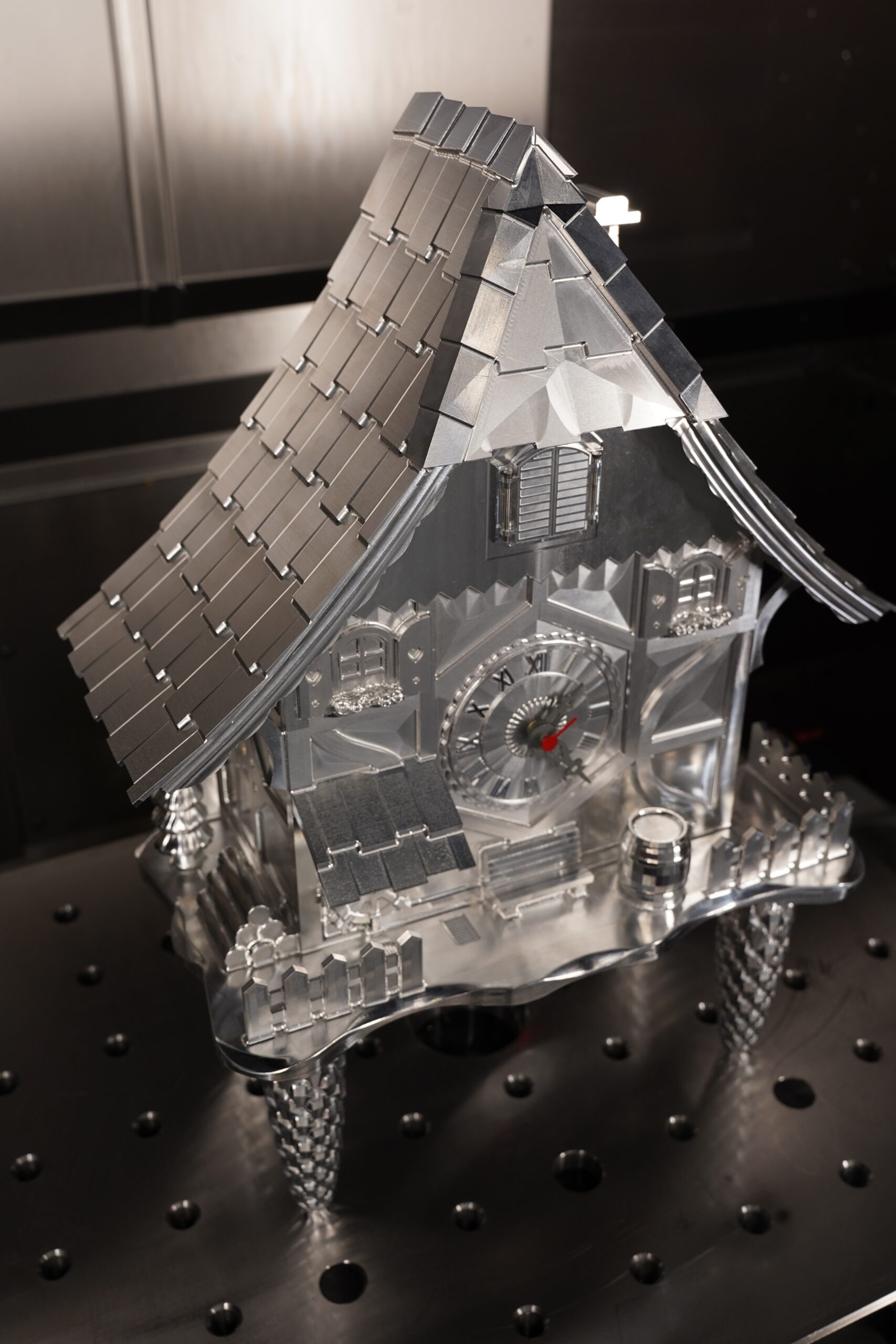

The Hermle Cuckoo Clock: Tradition Reimagined Through Technology
Our collaboration with Hermle Machine Tools on the Cuckoo Project pushed different boundaries entirely. Over eight intensive days at Hermle’s German facility, I worked alongside their application engineers to machine an aluminum cuckoo clock of unprecedented complexity—geometry that their seasoned aerospace engineers initially deemed impossible.
Starting with a 300x300x160mm solid aluminum block, we reimagined the classic Black Forest timepiece through advanced 5-axis machining, demonstrating sophisticated geometry handling and collaborative engineering excellence.
Advanced CAM Strategies in Action
This project showcased Mastercam’s most sophisticated capabilities:
- Convert to 5-Axis Functionality: Essential for driving toolpaths on mesh-based geometry, particularly around the intricate rooftop architecture and complex undercuts.
- Clean Core Algorithms: Navigated tight spaces like the organic tree forms beneath the roof, enabling precise tool movement in narrow cavities while maintaining collision avoidance.
- Unified Toolpath Technology: Combined parallel and guided cutting methods for superior surface finishes and tool control around architectural details.
- Multi-Axis Roughing: Efficiently removed bulk material while maintaining practical shop-floor execution parameters.
- Full 5-Axis Deburring: Leveraged complete machine kinematics and tilt control for consistent edge finishing across tall, narrow features.
The programming complexity required OptiRough and stock model exports to manage the job in executable stages, enhancing toolpath efficiency and stock awareness. Tool Axis Control took priority in constrained areas, reducing collision control dependency while enabling intelligent tool movement.
