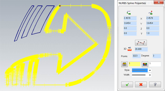

For example, I imported the Dynamic logo into 2017 using Mastercam Art, there are a couple of screenshots below. This single spline that defines the D has 3223 points.”

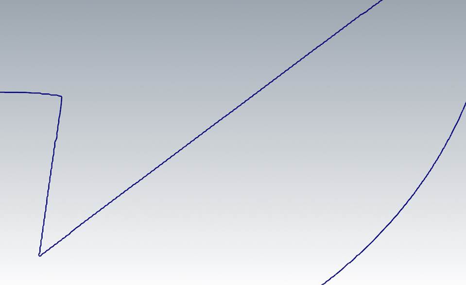

Refined Spline Interface:
Now has 670 points
